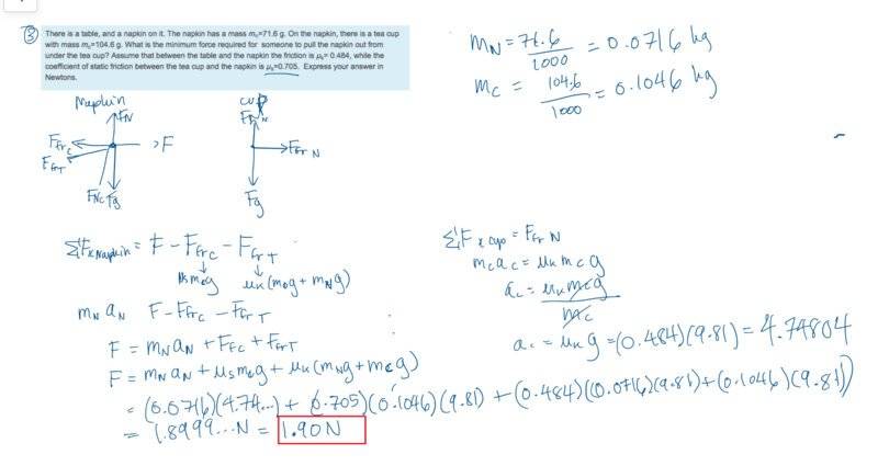

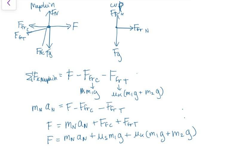

There is a table, and a napkin on it. The napkin has a mass mn=71.6 g. On the napkin, there is a tea cup with mass mc=104.6 g. What is the minimum force required for someone to pull the napkin out from under the tea cup? Assume that between the table and the napkin the friction is µk= 0.484, while the coefficient of static friction between the tea cup and the napkin is µs=0.705. Express your answer in Newtons.
F=ma
ΣFxNapkin=F-frC-frT (where C is cup and T is table)
ΣFxCup=frN (where N is napkin)
I have also included a photo of my FBD
How can I proceed with this question? Do I have a correct FBD?
Your FBD looks fine.
What about the cup's acceleration?
Would the acceleration of the cup be equal to the acceleration of the napkin?
Yes, or only very slightly less. So what equation can you write?
so would the cup acceleration be:
ackg ?
Which subsequently would be the acceleration of the napkin?
So would my solution in the picture make sense?
ackg ?
μk is the kinetic friction between the napkin and the table.
Likes Jpyhsics
Okay thanks!
Jpyhsics said:
Okay thanks!
Not sure how to interpret that response. I am telling you that your equation in post #5 makes no sense... and wondering if it was a typo.
