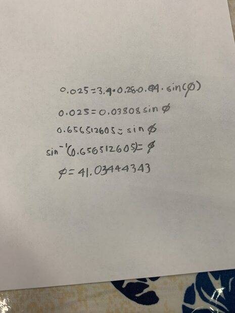

A straight wire 0.280 m in length carries a current of 3.40 A. What are the two angles between the direction of the current and the direction of a uniform 0.0400 T magnetic field for which the magnetic force on the wire has magnitude 0.0250 N?
F=ILBsin
I got 41 and correspondingly 49 from this. It said its wrong
Please show your work.
0.025=3.4*.28*.04sinx sin^-1(0.025/0.3808)=41
I have no idea where you got that, but am sure 0.025 does not equal 41.
I recommend that you show your work step by step and only put numbers in at the end.
The 0.3808 appears to be a typo for a tenth of that.
41o appears to be correct. But why did you choose the complementary angle (49o) for the second angle?
sin(41o) ≠ sin(49o)
cos^-1(0.6565) is 86.2 but that didn't work. How am I supposed to find a second angle?
Draw two straight lines crossing. If one of the angles formed is x, what is the other?
Alternatively, if x=a is one solution of sin(x)=y, what is the other in the range 0 to 360?
You have shown that sinθ = .6565. So, you need to find two angles θ for which sinθ = .6565
You probably remember that sin(30o) = 0.5
Can you think of another angle whose sine is 0.5? What is the relation between the two angles?
