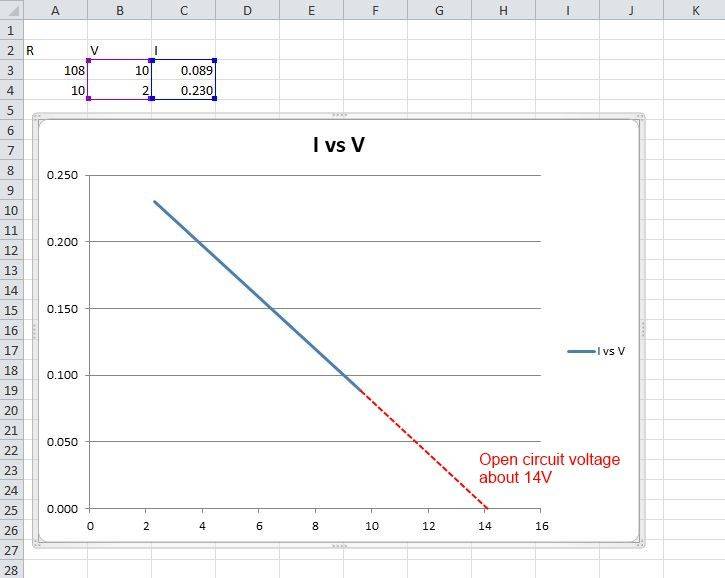

Writing and solving two simultaneous equations is the accurate way but you could also use a graphical method...
1) Calculate the output current for the data points you have (eg I = V/R)
2) Plot a graph of I vs V.
3) Extrapolate that to find the open circuit voltage (eg V at I=0).
The open circuit voltage looks to be about 14V
You can also do the same method to find the short circuit current.
Then use the open circuit voltage and short circuit current to calculate the internal resistance.
PS I think I used the right voltages but excel rounded them.

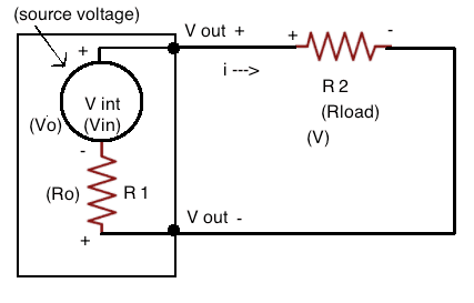

From scottdave's response, I interpolated the following:
Though, now we have at least 4 different annotations for the "internal voltage" of the supply.

As far as I can tell, I didn't use "a system of equations".
Though, in the end, we all came up with the same solution, so we may have a different definition for that phrase.

ps. My method of solving the problem is available, upon request. Though, I will not give the answer.
