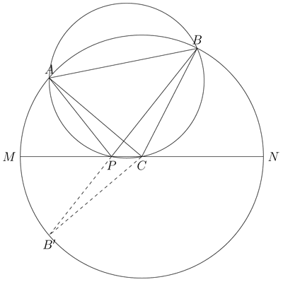

Points A,B are on circle C ,segment MN is a diameter of circle C, and point P is on
segment MN , if :
$\angle CAP=\angle CBP =10^o ,\,\, \overset{\frown} {MA}=40^o,\,\, find :\,\, \overset{\frown} {BN}=?$

[sp]
One solution is for $B$ to be opposite $A$ on the other side of $MN$, at the point labelled $B'$ in the picture. Then $\overset{\frown} {BN} = 140^\circ$. But that is too obvious to be interesting, and I assume that what was wanted is the case where $A$ and $B$ are on the same side of $MN$.
The points $A, B, C, P$ are concyclic, because $\angle CAP=\angle CBP =10^\circ$. Therefore $\angle ABP=\angle ACP =40^\circ$, and so $\angle ABC= 10^\circ + 40^\circ = 50^\circ.$ The triangle $ABC$ is isosceles, so $\angle BAC = 50^\circ$, and $\angle ACB =80^\circ$. Finally, $\angle BCP =40^\circ + 80^\circ = 120^\circ$, from which $\overset{\frown} {BN}= \angle BCN = 60^\circ.$[/sp]

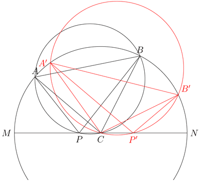

what will be the value of arc BN , if point P locates between points C and N
Good question! I hadn't thought of that possibility. The method will be similar to the previous one, but this time the angle ABC ($\angle A'B'C$ in the diagram below) will be $40^\circ - 10^\circ = 30^\circ$ instead of $40^\circ + 10^\circ = 50^\circ$. Then $\angle A'CB' = 120^\circ$ and $\overset{\frown} {BN} = 20^\circ.$
