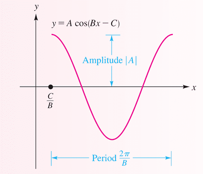

Do you know how to graph a function of the form ##f(x)=A\cos(Bx-C)## in general? If not then the following may help you:
To see the difference between ##f(x)=\cos x ## and ##g(x)=\cos (x+L)##, I've ploted this graphic for various values of ##L##. And as you can see, they shift the graph of ##\cos x## by a horizontal amount of ##L##.
Wow, thankyou again HakImPhilo, that diagram really helped!
