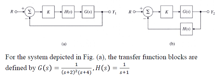

I am trying to answer two questions:
1. Solve part (b) in the image above by hand.
2. What are the differences between transfer function (a) and transfer function (b).
cos(Im(s) / Re(s)) = ζ
1. For part one given the damp I know that cos-1(ζ) = 45. Thus the magnitude of the real and imaginary parts of the root has to be the same. However I can't seem to think of a way to do this by hand. I can plot the root locus in Matlab.
Once I find the root locus I know I can find K by using:
[tex]K = \frac{|denominator \quad of \quad tf|}{|numerator \quad of \quad tf|} [/tex]2. The transfer functions are [tex]K = \frac{KGH}{1+KGH} [/tex] and [tex]K = \frac{KG}{1+KGH} [/tex] . Besides a different output response would the root locus and bode plots of the both transfer functions be the same?
The only solution I could think of is using the angle condition:
The phase should all add up to 180 degrees + a multiple of 360:
SInce the damping results in a 45 degree angle, the real and imaginary parts of s are the same. Thus:
[tex]s = -x + xj [/tex]
I can then apply the angle criterion by getting the phase of each pole:
[tex]\sum\angle(zeroes) - \sum\angle(poles) = 180 \pm 360*n[/tex]
[tex]-2*tan^{-1}(\frac{x}{-x+2})-tan^{-1}(\frac{x}{-x+4})-tan^{-1}(\frac{x}{-x+1}) = 180[/tex]
I had to brute force and solve this in my calculator and got x = 2.203. I had to then try setting the equation equal to -180 as opposed to 180:
[tex]-2*tan^{-1}(\frac{x}{-x+2})-tan^{-1}(\frac{x}{-x+4})-tan^{-1}(\frac{x}{-x+1}) = -180[/tex]
and got x = .907672 which is the right answer.
Is there a better way to do this without numerically solving it?
