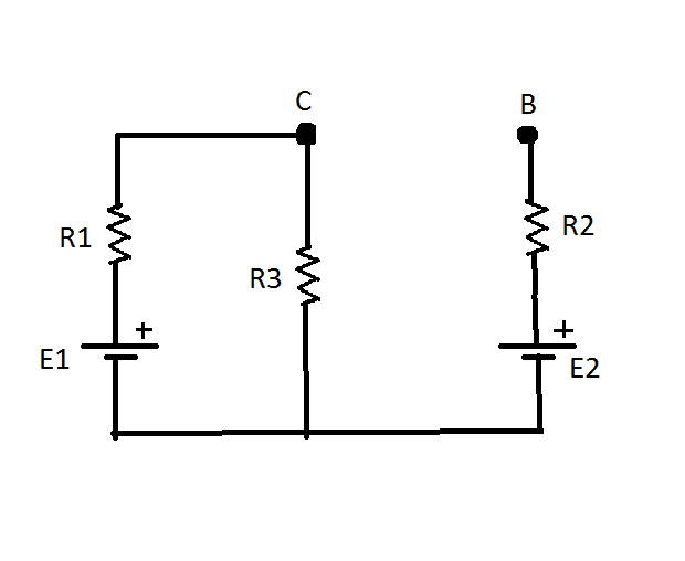

R1 = 120ohms
R2 = 820ohms
R3 = 2200ohms
E1 = 15v
E2 = 9v
What is the potential difference between points "B" and "C"?
(I've attached the circuit diagram)
What have you learned about electric current and electric potential so far?

You should write them under the title "Relevant equations".
And then show some attempt to solve the problem.
As a first hint: Does any current flow through resistor R2?
ehild

ok I think there is no current flowing through the R2

Very well, so what do you know about the potential drop across R2?

No, you just said that zero current flows through R2. And you know Ohm's law. What does it say? ehild

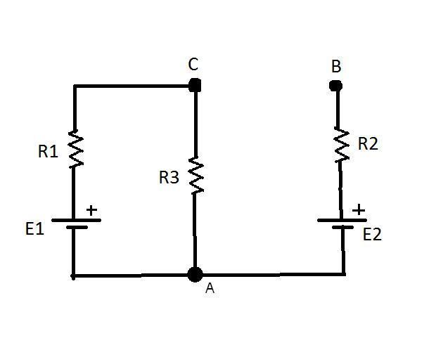

What is the potential difference between A and B? We will assign the zero of potential to point A. ehild

According to Ohm's law, zero current means zero potential difference across a resistor. So the potential at B is the same as at the positive terminal of the battery E2.
There is current in the closed loop at the LHS of the drawing: KVL can be applied to get it. The potential of B with respect to A is obtained from Ohm's law again. If you know the potential both at B and C the potential difference is just a subtraction.
ehild

Total Resistance = R1+R3 = (120+2200)ohms
consider current through Resister R1 and R3 is "I"
then I=E1/(R1+R3) = 15/(120+2200) = 0.0065A
At point "C" let's assume there to be zero potential
1) by going over R3 we lose -14.3V (0.0065*R3)
2) The E2 power supply adds 9V, leaving us with -5.3V (-14.3V + 9V)
3) no current flows through R2
4) therefor the potential different between point "B" and "C" is 5.3V
is this correct??
Yes, but add for clarity that B is negative with respect to C.
ehild

The answer depends how your teacher defined the potential difference between two points, say B and C. It might be Ub-Uc or Uc-Ub. But it is always correct if you give the absolute value and indicate which point is more positive or more negative than the other one.

You are welcome.:smile:. And one more little hint: When doing calculations, do not round the data too early, too much. You rounded the current to two significant digits so the error of the result is 0.1 V. During calculations, keep at least one more significant digits as needed in the final result.

Just a little hint, the same I said to harshakantha: Do not round off too much during the calculations. That current was 0.00647 with 3 digits. Both of you rounded it to 0.0065 which caused an error of 0.066 V in the voltage in harshakantha's calculation as he multiplied it with the bigger resistance. You used the smaller resistance, so your error is one magnitude less, 0.004 V.
