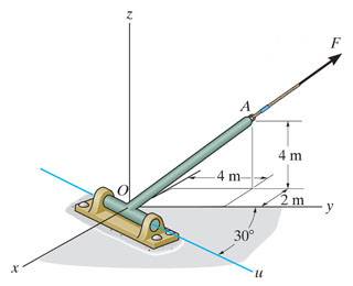

Determine the magnitude of the projection of force F = 700N along the u axis.
Cosθ = (A • B)/(||A|| * ||B||)
I'm guessing I have to use the above equation, but my problem is finding the B vector. A is easy enough (<-2, 4, 4> I believe), but what about that B? Or am I thinking of this in the wrong way?

You have a generic formula for ##\cos\theta##. What two vectors are A and B in your problem?
Well, I'd say A would be from the origin to A. I have no idea what B would be as there's only two lines, one point, and no other coordinates besides for the beam.
It looks to me like the "B" vector would be a vector from the origin along the direction u.

It looks like A is the point at the end of the hardware. But you are given a force vector ##\vec F##. That would be your A. And it asks for the projection along the ##u## axis. Isn't that a hint for B? And you are going to need the formula for the magnitude of the projection of one vector on another.
Well there's no coordinates anywhere along the u axis so I don't know how to find the vector for it . . . And are you talking about the formula F[itex]_{}parallel[/itex] = Fcos[itex]\theta[/itex]? How would I use that in this problem since it doesn't give the required answer . . .

Your vector u is in the xy plane. You have an angle given. Can you figure out the components of a unit vector in the direction of u?
Alright, so my unit vector is <(1/2),(rt(3)/2,0>? My A vector is <-2,4,4>? Where do I use the 700N? Is it really:
<(1/2), (rt(3)/2), 0> • <-2, 4, 4> = 700cos(30)B?

U = < 1/2, [itex]\sqrt{}3[/itex]/2, 0 > (unit vector on the "u" line)
A = < 233.33, 466.67, 466.67 > (unit vector of the force multiplied by 700)
U • A = ||A||*||B||*cosθ, where ||A|| = 700 and θ = 30°
Is this right?

Ok, so here's what I ended up doing.. I have two more problems for this section, but I want to know if I'm doing it right (so expect more topics . . . or hopefully not if I'm understanding).
I took ##\vec F## (the coordinates of point A multiplied by the magnitude of F) and dotted it with 30-60-90 unit triangle (which had no z components). Essentially ##\vec u## • ##\vec x##, though my x in this case was ##\vec F##. Then I multiplied by my unit vector and got 290, the answer.

It sounds like you took ##\vec u\cdot\vec F## (a number) and multiplied it by ##\vec u## (a vector), and got the final answer ##(\vec u\cdot\vec F)\vec u## (a vector), and then you said that this is equal to 290 (a number).
I still think you did the right thing, which is to calculate ##|\vec u\cdot\vec F|##. I got a result close to 290, but not quite that. It's of course possible that I've made a mistake, but I have to ask if you're rounding off to the nearest multiple of 10 or something like that.

Hm, rounded off to the nearest integer, I got 287. I guess you also rounded off intermediate results. If you're going to do that, you should include a few extra decimals in the intermediate results.
\begin{align}
&\vec F=\frac{700}{\sqrt{36}}(-2,4,4)\\
&\vec u=\bigg(\frac{1}{2},\frac{\sqrt 3}{2},0\bigg)\\
&\|\vec F\cdot\vec u\| =\frac{700}{\sqrt{36}}\big((-2)\frac{1}{2}+4\frac{\sqrt{3}}{2}+4\times 0\big) =\frac{700}{\sqrt{36}}(-1+2\sqrt{3})\approx 287.
