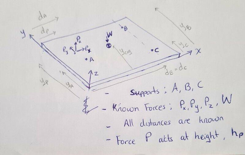

I was hoping someone could help me determining the reaction forces of a plate supported at three points (see image attached). I was able to find the reaction with only the weight of the plate, but now there is a force with three vectors Px, Py and Pz acting at a point on the plate. So basically with the addition of forces in the x and y axis, I now have to find the reaction forces at all three supports in all 3 vectors (i.e. 9 variables). But with only 6 equations of equilibrium. I was able to find All reactions in the z axis; Az, Bz, Cz ( which by the way is not shown in the images attached). But I am stuck as the X and Y axis reactions can only be expressed interms of each other ( e.g., Ay = Cx × constant) as only eqn 3 (sum of Mz) relates them, so I am unable to solve it.
I know this actual system is not statistically indeterminate nor imbalanced as it is used in real life applications. So am I missing something important here. Pls help!!!

Is the plate supported from below?
Lnewqban said:
Welcome!
Yes, the 3 supports are holding it from below indeed
Then, is there some relevant vertical distance (hp) between the point of application of force P and the three suports to be considered?
Yes there is.. i forgot to add it to the diagram, but I mentioned it in the note, the force P is applied at a certain distance hp above the plate
Therefore, Px and Py each induce some moment about axes y and x respectively, besides the evident moments created by Pz.

Taking Px as example, and if supports A, B and C can restrain movement in that direction, the x-reaction force at each support should be proportional to the y distance of each respect to point of application of Px.
In that situation, you have more points of support than needed, the x-y plane is indeterminate.
