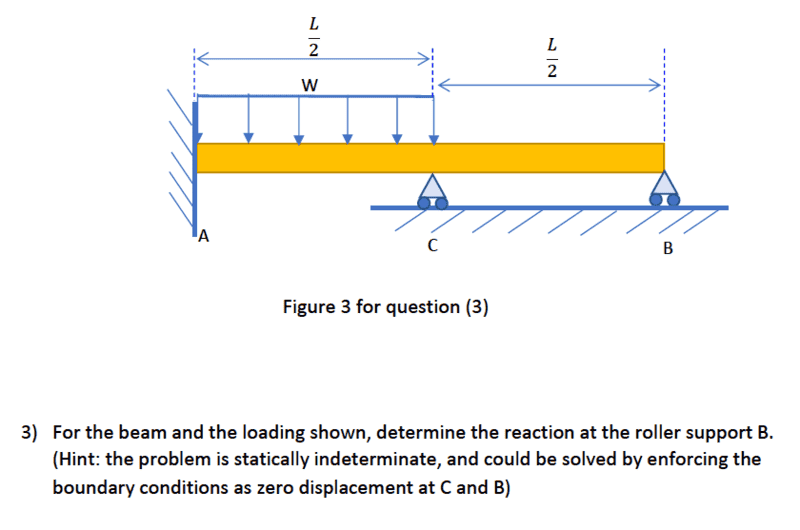

In summary, the homework statement is that boundary conditions must be met for the EI(d^4y/dx^4)=w equation to be valid. The Attempt at a Solution found that the boundary condition at A is that x=0, y=0, slope=0. At C, x=L/2, y=0, shear force = -Rb and at B, x=L, y=0, moment = 0. However, with this 5 equations, with 4 unknowns, and the boundary conditions, it seems Rb cannot be solved out. May I know how should I tackle this problem?

Boundary condition
EI(d^4y/dx^4)=w
Boundary condition:
At A, x=0, y=0, slope=0
At B, x=L, y=0, moment = 0, shear force = 0
I know there are 2 distinctive formulae for A-C and C-B.
For A-C:
Load: EI(d^4y/dx^4)=w -----(1)
Shear:EI(d^3y/dx^3)=wx+A-----(2)
Moment: EI(d^2y/dx^2)=1/2*wx^2+Ax+B-----(3)
EI(dy/dx)=1/6*wx^3+1/6*Ax^2+Bx+C-----(4)
EIy=1/24*wx^4+1/6*Ax^3+1/2*Bx^2+Cx+D-----(5)
Thank you

Eeek! Are you familiar with cantilever deflection equations that can be obtained from beam tables? One way to solve this problem is to remove the 2 roller supports and then calculate the beam deflection at those removed supports, then put them back one at a time as a unit load and calculate the deflections at those same points. Ultimately you solve for these reactions knowing that the deflection at the support points is 0.

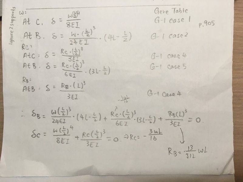

Should I do it this way?
But as the true deflection at C is 0, should the assumed deflection at B be the difference in deflection between B and C?
Thanks

The only assumption you need to make is the one noted by Haruspex, assume roller can take vertical loads in both directions. Otherwise, it does not appear that you are using the tables properly. The slope of the deflected curve at the free ends is given as an an angle theta in radians, and once you know the deflection and angle at C, then the deflection at B is that deflection plus, for small angles, (theta)(L/2). Do the same for the other reaction, calculating deflection at both joints. Then add up the deflections at each point for the 3 cases and set them equal to zero. But you must watch your plus and minus signs.
Am i correct to calculate like this?
Thanks

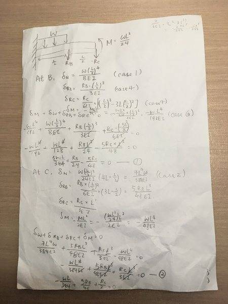

I held off replying to this until I was satisfied I had the solution. (It is W/28 downwards.)
I didn't use your method. I wrote out the differential equations for the two sections and solved them.
But now I am having trouble following yours, not least for readability.
You seem to have swapped B and C wrt the original diagram (which did assign A, B, C weirdly).
If you can be bothered to repost, typing in your algebra instead of posting an image, I will try to find your error(s). To make it easier, you can substitute L=2, EI=1 and abbreviate the reactions to A, B, C.
