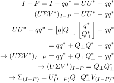

b)
And again I can't help but feel this is too general or that I'm missing something.

So, now, I think I figured out part a, thanks to you, and it seems to work on paper. And I THINK I have figured out part b, setting it up along the lines of:
And then solving for the Σ_orthog and using the orthogonal U and U* from the left side to work towards a final answer...hopefully I set that up correctly.

Mattbringssoda said:
Oh, I see. I forgot about that...
The next portion of the question is to get the SVD of I-2P. We just worked on I-P above, and it's orthogonality to P helped me get to the answer, but I'm not sure how to set up I-2P.
I know it's a reflection across the null, so that probably adds some "negative" values somewhere, but I'm not sure the proper way to show that in this symbolic representation problem that we're doing here...
Am I missing something obvious again, or over thinking it?
Yep. Overlooking something.
We can use the property of distributivity to simplify - it applies to matrices as well.
That is, take the matrices out of the parentheses, so to speak.
##I-P = UU^* - UE_{11} U^* = U(U^* - E_{11} U^*) = U(I - E_{11})U^* = U\Sigma' U^*##
