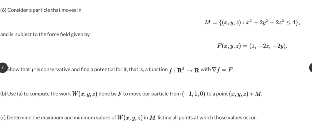

Consider a particle that moves in x^2+2y^2+2z^2<=4 and is subject to the force field f(x,y,z)= (1,-2z,-2y). If f=grad(F), find the values in this region that maximize f.
grad(F)=0 to find extrema
Lagrange Mulitpliers Technique
I found that f= x -2yz. To maximize f, I can first inspect the solutions to grad(F)=0. z=y=0 pops out, but I'm not sure what to do with the x-component equaling 1. Do we just include (x,0,0) as a solution? I think the problem wants specifics though, based on what I've seen previously from problem sets by this instructor.
Using Lagrange Multipliers, we get:
1=2xλ
-2z=4yλ
-2y=4zλ
Working through this, I find that z(1-4λ)=0. If z=0, then y=0. If λ=1/4, then y=-z/2 and x=2. So it appears we have (x,0,0) (as before) and (2, -z/2, z).
I'm not sure how to work through these to get the specifics here. Am I missing something, or is this a departure from this instructor's typical problems? Also, I don't think I need to parameterize and look for points inside the boundary here because of the Laplacian being equal to zero (I read that somewhere, but could be mistaken).

Attached is the question, and I'm working on part c. I'm maximizing f, and thus looking at F, because it's the gradient. My work was showing setting (1,-2z,-2y)=0, but I don't know what 1=0 implies for the x-component. Also, with Lagrange I don't get anything that creates definitive values, but I believe I need them.
but meant to write is subject to the force field ##\ \vec F(x,y,z)= (1,-2z,-2y).\ ## If ##\ \vec F=\vec\nabla (f) ##...
You found, correctly, ##f = x-2yz##.
What did you do to show that ##\vec F ## is conservative ?
In part (b) you found the ##W## that @etotheipi mentions, and finding extrema for that amounts to finding extrema for ##f##.
Lagrange multipliers work for constraints that can be written as equalities. Make an educated guess and search on ##x^2+2y^2+2z^2\ {\bf =} \ 4\;##. Check later.

Anyway, you have the constraint (plus the guess) and want to tackle
1=2xλ
-2z=4yλ
-2y=4zλ
But that is four unknowns and three equations. You need a fourth equation: the constraint !
I get ##\ z(1-4\lambda^2) = 0\ ## (or did I just bump into another typo :wink: )
Keep going !

Haha, yeah, I definitely made a mistake there. λ=1/2 or -1/2. Thanks for the hint on adding the constraint, that makes sense and helps pull it together conceptually.
OK so, I have a few paths: λ=1/2 implies y=-z and x=1, so I get (1, -z, z), whereas λ=-1/2 implies y=z and x= -1, so I get (-1, z, z). We still have the y=z=0 path from before, so I get (x, 0, 0).
Using the constraint for (1, -z, z) we see that z=sqrt(3)/2 or z=-sqrt(3)/2. I get the same thing for (-1, z, z). Then for (x, 0, 0), I get x=2 and x=-2.
So in total, I think my critical points are
(1, -sqrt(3)/2, sqrt(3)/2), (1, sqrt(3)/2, -sqrt(3)/2), (-1, sqrt(3)/2, sqrt(3)/2), (-1, -sqrt(3)/2, -sqrt(3)/2), (2, 0, 0), (-2, 0, 0). I can plug those into W to find which are absolute global max and mins. And then that's basically it I believe.
And to be clear, the reason I can ignore the points inside the boundary is because the laplacian of f = 0, and if it weren't, I'd need to parameterize the f?

Plus ##x^2+2y^2+2z^2\ {\bf =} \ 4\;## gets you one single point as answer for this ##\lambda##. Check by sketching the ##yz## plane for x = 1.
