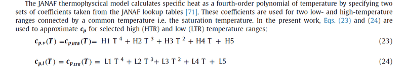

I am trying to find the specific heat (at constant pressure) ##C_p## coefficients linked to the JANAF model
I am trying to find the specific heat (at constant pressure) ##C_p## coefficients linked to the JANAF model, which basically assumes that ##C_p## is a polynomic function of ##T##, for liquid nitrogen (at ##\approx## 97 K).
Before doing that, I am trying to find those for water (at ##\approx## 300 K) and verify that they are ##9850.69, -48.6714, 0.13736## and ##-0.000127063##.
I am looking into NIST data for water; I checked both gas and condensed thermochemistry data but the coefficients don't match with the above. I also checked the NIST-JANAF thermo tables, for water, but the coefficients are not there.
How to find the desired coefficients for water (at ##\approx## 300 K)? They should be somewhere in the NIST-JANAF table.
Once I see the above it should be straightforward to find those for liquid nitrogen
Thank you! :biggrin:

Just for the record, here's an explanation of the JANAF model
BvU said:
Where do these come from ? How do they lead to a ##\ c_p=75.349\ ## J/(K.mol) as expected ?
Good question, here is the derivation.
I am trying to find the coefficients for liquid nitrogen online. However, I think the best I could do is follow the same procedure to derive them (not only for ##c_p## but for the density, dynamic viscosity and thermal conductivity).
So I am going to take the temperature range ##-193 < T < -173## Celsius (using ##80K < T < 100K## should also work).
First I am trying to find the density, ##c_p##, dynamic viscosity and thermal conductivity data associated to this temperature range (as done for water in the above derivation).
Still think there is a mismatch somewhere. I can find no way to get a reasonable ##c_p## with e.g. formula ##(23)## or ##(24)## with such coefficients $$9850.69*300^4 -48.6714*300^3+ 0.13736*300^2 -0.000127063*300 = 7.979 \times 10^{13}\ \ ?$$

The NIST data is for the Shomate equation, which is not polynomial (note the ##E/t^2## term).
Likes JD_PM
There are no formulas numbered 23 nor 24. Did you mean 7.4 here?
