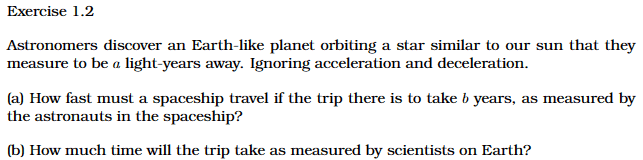

For this problem,
My working,
(a) ##d = a~ly = ac~y##
##v = \frac{d}{\Delta t} = \frac{ac}{b} \frac{m}{s}##
(b) Lorentz factor is ##γ = \frac{1}{1 - \frac{a^2}{b^2}}## Thus time dilation is ##\Delta t = \frac{b}{1 - \frac{a^2}{b^2}} y##, however, I think my arugment is only valid if ##a >> b## in ##\frac{a}{b}## so ##v \approx c##.
Is that please correct?
Thanks!
(a) The distance between the Earth and the star is contracted for the pilot. You should take it.
(b) The distance for the Earth / v of (a)
Thank you for your reply @anuttarasammyak !
So I'm slightly confused. If the distance is length contracted then we end up wiht a very ugly polynomial to solve which is from ##v = \frac{L_0}{(\sqrt{1 - \frac{v^2}{c^2}})\Delta t}##
Squaring both sides gives
This gives ##-\frac{v^4}{c^2} + v^2 - \frac{L^2_0}{\Delta t^2} = 0##, which I would need to use the quadratic formula to solve. Is that what you were intending?
Where I leave in terms of ##v## since otherwise it gets even more ugly.
Thanks!

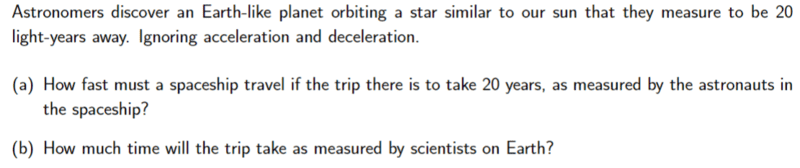

Here is a version of the problem with numbers in it. Maybe it would be easier to solve numerically then generalize symbolically.
Thanks!
ChiralSuperfields said:
So I'm slightly confused. If the distance is length contracted then we end up wiht a very ugly polynomial to solve which is from v=L0(1−v2c2)Δt
This gives −v4c2+v2−L02Δt2=0, which I would need to use the quadratic formula to solve. Is that what you were intending?
Though I do not follow you, how about
[tex]\sqrt{1-\beta^2}\ a=\beta \ c b[/tex]
where
[tex]\beta=\frac{v}{c}[/tex] ?
