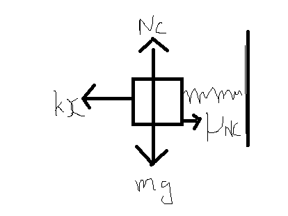

Josh pushes a box of mass m which then travels on a horizontal surface. There is a coefficient of
kinetic friction μ between the box and the surface. The box has speed v when it reaches x = 0 and
encounters a spring. The box compresses the spring, stops, and then recoils and travels in the opposite direction. When the box reaches x = 0 on its return trip, it stops.
Determine k, the spring constant, in terms of μ, m, g, and v.
is the diagram I have drawn correct?
If it is, I can use F=ma in x & y direction.
However, how can I get V into this equation?
Your diagram is okay as far as the forces involved. Have you considered a conservation of energy approach?

Would it go like this:
Intial Kinetic energy + Potential energy (0.5*k*x^2) - work (µ*nc*x) = final kinetic energy (0 as it is in rest in final position)
is this correct? I don't understand the value for x though?
You have two unknowns here. One is the spring constant and the other is the compression distance, which is your "x". Having two unknowns implies you'll need two equations, right?
You know what the total energy is to begin with (it's all kinetic and you have the mass and velocity as givens). You should also know what the final energy is and where it's "located". Write energy balance equations for the times when the KE is known to be zero...

No, that equation doesn't look correct when the spring compression is x (fully compressed), although it's close. The system starts out with all the energy as KE. That's your 0.5mv^2 term. When the spring is fully compressed the new KE is zero but the spring has stored PE and some energy has been lost due to friction. Write the energy balance accordingly: OLD = NEW. So something like
KEi = PEs + Wf
Where KEi is the initial KE, PEs is the spring PE, Wf is the work done by friction. Use the appropriate expressions for the terms.
Write the second equation for when the block has returned to the starting point from the fully compressed position. For that portion of the trip the initial energy was all stored in the spring as PE, so that's your "OLD" part of the balance. Where's all the "NEW" energy at the end of the trip?
