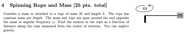

Consider a mass m attached to a rope of mass M and length L. The rope has constant mass per length. The mass and rope are spun around the end opposite the mass at angular frequency ω. Find the tension in the rope as a function of distance along the rope measured from the center of rotation. You can neglect gravity.
a = v^2/r
I'm not too sure how to account for both the mass and the rope at once.
I think the following are true for the two individually:
For the mass at the end, ## T = m ω^2 L ##, following from ##a = v^2/r##and ##v=ωr##.
For the rope, ##dT = ω^2 r dM##, where ##dM = λ dr## and λ is the mass per unit length = M/L.
Therefore, ##dT = λ ω^2 r dr##, so ##T = \frac{1} {2} λ ω^2 r^2## integrating from 0 to r on the right-hand side.
Knowing this, I'm not sure how to put this information together because it seems like having the mass at the end might change how to solve the problem, but I'm not sure how to go about approaching this.

##dT=-\lambda\omega^2rdr\Rightarrow T=-\frac{1}{2}\lambda\omega^2r^2+C##
Could I then use ##T=m\omega^2L##, the tension that is needed for the block to find C?
i.e.:
##T(L)=-m\omega^2L=-\frac{1}{2}\lambda\omega^2L^2+C =-\frac{1}{2}(\frac{M}{L})\omega^2L^2+C =-\frac{1}{2}M\omega^2L+C##
I believe the boundary condition is ##T(L)=m\omega^2L## in your analysis you "silently" assumed that the positive direction is inwards, that is towards the center.

Got it! Ok, so correcting for this: ##m\omega^2L=-\frac{1}{2}M\omega^2L+C \Rightarrow C=m\omega^2L+\frac{1}{2}M\omega^2L=\omega^2L(m+\frac{1}{2}M)##.
So the final answer would be: ##T(r)=\omega^2L(m+\frac{1}{2}M)-\frac{M}{2L}\omega^2r^2##?

Yes now I think you are absolutely correct.
Likes vparam
I would probably group it as follows
T(r) = m\omega^2 L + \frac{M}{2}\omega^2 L\left(1 - \frac{r^2}{L^2}\right),
but yes.
So what is the tension at ##r = 0##? Does this result seem compatible with what you would experience if you were to swing an object attached to a string around over your head?

Evaluating at r=0, ##T(0)=m\omega^2L+\frac{M}{2}\omega^2L##. I see what you mean now: yes, it makes sense that the tension is at a maximum at r=0 based on experience.
