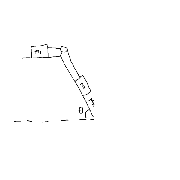

m1 is on a frictionless surface and m2 is on a surface with a coefficient of friction of μ.
Find the acceleration of the blocks in terms of m1, m2, g, Ѳ, μ
ΣF=a*m
a=m2gsinѲ/m1+m2
is this correct??

knewman55 said:
is this correct??
No. What happened to the friction?
How would I implement that?
There is a standard way to proceed.
For each rigid body in the system, draw a Free Body Diagram.
Assign variables to all the forces, masses and accelerations on/of each.
Figure out any relationships between the forces on the different masses, likewise their accelerations.
Write out the ΣF=ma equation for each body.
