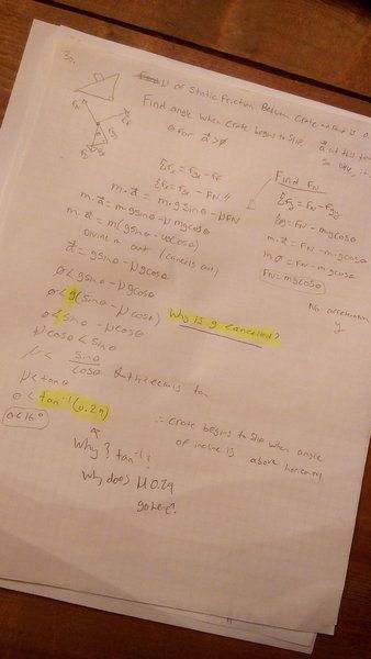

A crate is placed on an adjustable, inclined board. The coefficient of static friction between the crate and the board is 0.29. A) Calculate the angle at which the crate just begins to slip.
Sum of Forces=M*A
In my problem: Why is g cancelled? and why is 0.29 added to tan^-1
These are highlighted areas

so it looks like you have in the one section: = 0 < g*(sinθ - μ*cosθ). Just multiply both sides by 1/g and you have 0/g < (g/g)*(sinθ - μ*cosθ). 0/g is 0, and g/g is 1.
For the last part, they get it down to μ < tanθ, then plug in μ=0.29 which is given in the problem statement. Take inverse tangent of both sides to find θ.

Anyway, scottdave has posted the answers to the OP questions.
