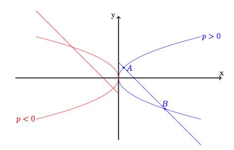

Find area bounded by parabola [itex]y^2=2px,p\in\mathbb R[/itex] and normal to parabola that closes an angle [itex]\alpha=\frac{3\pi}{4}[/itex] with the positive [itex]Ox[/itex] axis.
-Area
-Integration
-Analytic geometry
For [itex]p>0[/itex] we can find the normal to parabola such that it closes an angle [itex]\alpha[/itex] with positive [itex]Ox[/itex] axis. For [itex]p<0[/itex] we can't find a normal on parabola for given condition.
Point [itex]A[/itex] in first quadrant where the angle between positive [itex]Ox[/itex] axis and parabola is found by
[itex]y=\sqrt{2px},y'=1\Rightarrow A\left(\frac{p}{2},p\right),p>0[/itex].
Now we can find the line that contains point [itex]A[/itex]:
[itex]y-p=-x+\frac{p}{2}\Rightarrow y=-x+\frac{3p}{2},p>0[/itex].
This is the normal on parabola that satisfies the condition for [itex]\alpha[/itex].
Second point of the normal is found by solving the system:
[itex]y=-x+\frac{3p}{2},y^2=2px\Rightarrow x=\frac{3p}{2}-y\Rightarrow y_1=-3p,y_2=p[/itex]. Point [itex]B[/itex] has to be in the fourth quadrant, so [itex]B=\left(\frac{9p}{2},-3p\right),p>0[/itex].
Now the problem is reduced: Find the area bounded by [itex]y^2=2px[/itex] and [itex]y=-x+\frac{3p}{2}[/itex] where [itex]p>0[/itex] which is the area [itex]AOB[/itex].

I am getting the negative result for total area. Here is how I integrated:
[itex]A=A_1-A_2[/itex] where [itex]A_1[/itex] is the area below [itex]y^2=2px,p>0[/itex] on interval [itex][-3p,p][/itex] integrating on [itex]y[/itex] axis.
[itex]A_2[/itex] is the area below [itex]y=-x+\frac{3p}{2},p>0[/itex] on interval [itex][-3p,p][/itex] integrating on [itex]y[/itex] axis.
[itex]\int\limits_{-3p}^p \left(\frac{y^2}{2}-\frac{3p-2y}{2}\right)\mathrm dy[/itex]
[itex]A_1=\int\limits_{-3p}^{p} \frac{y^2}{2}\mathrm dy=\frac{14p^3}{3},p>0[/itex]
[itex]A_2=\int\limits_{-3p}^{p}\frac{3p-2y}{2} \mathrm dy=10p^2[/itex]
[itex]A=A_1-A_2=\frac{2p^2(7p-15)}{2}[/itex]
Why is this wrong? It should be positive for every [itex]p>0[/itex], right?

I will again explain how the easy method should work (but I think I get the wrong area result):
We look at a graph for [itex]p>0[/itex]. From my original post, the coordinates of [itex]A[/itex] and [itex]B[/itex] are [itex]A=\left(\frac{p}{2},p\right),B\left(\frac{9p}{2},-3p\right)[/itex]. We need to find the area [itex]AOB[/itex]. If we rotate coordinate plane by [itex]\pi/2[/itex], we will see that the area below parabola minus the area below orthogonal line will give the area [itex]AOB[/itex].
Integrating along [itex]y[/itex] axis gives area below parabola: [itex]A_1=\int_{-3p}^p \frac{y^2}{2}\mathrm dx[/itex].
Integrating along [itex]y[/itex] axis gives area below orthogonal line: [itex]A_2=\int_{-3p}^p \frac{3p-2y}{2}\mathrm dx[/itex].
Subtracting [itex]A_1[/itex] from [itex]A_2[/itex] gives the result from my previous post.
I still don't understand why this is not working?
The diagram reveals I had maybe misunderstood the question. I understood
Which does not seem to me very good English, to mean the area cut off by the parabola, the normal, and the x-axis.
But assuming your understanding is what was meant then your limits are OK, then what do you have shown look to be all OK. And calculating it I get a positive quantity, 2/3 p2 (though I easily make errors of calculation). So maybe it is some error in the calculation.)
(Have to close for tonight now).
"Subtracting A1 from A2" is the opposite of what you do in #4, I think. Mentioned before.
I see Geoffrey gets same result as I do.
