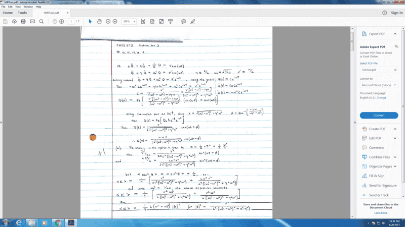

Q(t) = Aei(wt+Φ); dQ/dt = i*w*Q(t); E = (L/2)(dQ/dt)2 + Q2/2C
i = √-1 E above is average energy
When I plug in Q(t) & dQ/dt into equation above (E) I get:
A2L/2(w02-w2)cos[2(wt+Φ)]
w02 = 1/LC
After I plugged both of them in I simplified & took the real part. Why aren't I getting the answer?
I don't think the Real part represents the amount of energy which is stored in the cap and inductor. Note that resistors do not store energy.
Well in the answer the teacher gave, he took the real parts of Q(t) & dQ/dt. He then plugged them into the E formula above. Why does this work and my approach doea not (I take the real part AFTER equations are plugged in).

Suppose that there is not a resistor at all. There will not be any real part, yet there is energy stored (and transferring back and forth) between inductor and capacitor.
Here's the entire answer. Why doesn't my approach work?
The screenshot is too blurry for me to make out. Is it possible to upload (or link to) the PDF? Perhaps Slideshare.net if this site does not support it.
I understand taking the real part, now. They found it easier to work with e^(iwt), rather than cos(wt) then just took the real part, because e^(ix) = cos(x) + i*sin(x).
Yes, I know that they plugged in Q(t) = Aeiwt into the differential equation & found A. Then they took Re(Aeiwt) & plugged that into energy equation for part a. I still don't understand this: Why can't you plug in Aeiwt into the energy equation as opposed to its real part?

There's a little more to it than that. Recognize that your instructor's solution first converted/transformed the differential equation from the time domain to the phasor domain by replacing [itex] V' \cos(\omega t)[/itex] with [itex] V' e^{i \omega t} [/itex]. The steady-state solution of the differential equation was then found in the phasor domain. The solution was then converted back to the time domain (from the phasor domain) by taking the projection of the solution onto the real axis, [itex] Q_0 A e^{i \omega t + \phi} \rightarrow \Re \left[ Q_0 A e^{i \omega t + \phi} \right] = \Re [Q_0 A] \cos(\omega t + \phi) [/itex].
In summary, the process is:
1) Convert (i.e., transform) to the phasor domain. (Convert from real sinusoidal to complex spiral)
2) Solve the special case, steady-state solution to the differential equation (ignoring all transients).
3) Convert back to the time domain by finding the real projection of the complex solution.
Why do this? Why convert to the phasor domain in the first place? Answer: it just makes the math a little easier. It's easier to work with [itex] e^{i \omega t} [/itex] than it is with [itex] \cos(\omega t) [/itex]. That's all.
You could have solved the differential equation in terms of [itex] cos(\omega t + \phi) [/itex] from the beginning, but it would have been a lot harder. It's easier to first transform [itex] V' \cos(\omega t) \rightarrow V' e^{i \omega t} [/itex], solve for the steady-state solution, then transform back via [itex] Q_0 A e^{i \omega t + \phi} \rightarrow \Re \left[ Q_0 A e^{i \omega t + \phi} \right] = \Re [Q_0 A] \cos(\omega t + \phi) [/itex].
By the way, this process of solving the steady-state solution by way of the phasor domain transformation is done by electrical engineers all the time. They even have special notation where [itex] Ae^{i \omega t + \theta} = A \angle \theta [/itex]. Your instructor's solution does not use this notation, but mathematically it's the same thing.
