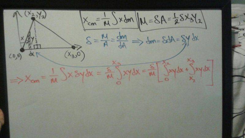

This is the set up that I'm thinking about, not sure if its okay though.
It is all right, but you have to substitute the y(x) functions for both domains ( from 0 to x2 and from x2 to x3)
so from 0 to x2 I can use y(x) = (y2/x2)x and from x2 to x3 y(x) = qx - qx3 Where q = -y2/(x3-x2) ?
Right.

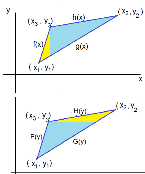

Make a picture and show what you mean.
The integration can be performed for the general position of the triangle, integration between the sides, with respect to x (first picture) or y (second picture).

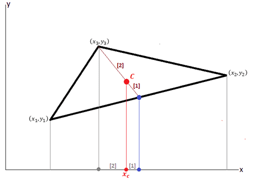

It is easy to argue that the center of mass lies at the intersection of the medians of the triangle. Using geometry you can prove that the point of intersection of the medians divides each median into two segments that are in a 2 to 1 ratio (indicated by the [2] and [1] on the median drawn in the diagram below). Find an expression for ##x_c## in terms of the x-coordinates of the gray and blue points on the x-axis.
