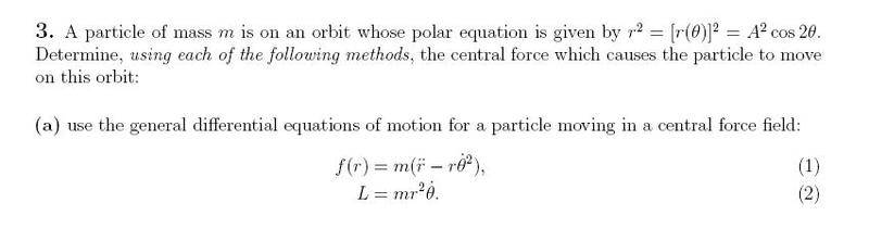

on image
The first thing I did was use the second equation to get
Theta dot = L/mr2
Which I then subbed into the first equation to eliminate Theta dot.
Now I need everything in terms of r, and this is where I get stuck.
If I just find the second derivative of r (r double dot), then sub it back in, I am left with all kinds of Thetas, but I need f as a function of r.
How do I proceed here? Any help is greatly appreciated! Thanks!
Derive the second equation: from that you get the second derivative of theta in terms of r and the first derivatives of both r and theta.
The first derivative of theta is just L/(mr^2).
And you have the equation of the orbit to find theta in terms of r.

I can not check your work if you do not show it in detail. Do you know what result you should get?
This is quite a weird orbit as it has sense only between -pi/4 and pi/4, otherwise r^2 would be negative.
Anyway, the derivation for a central force
is a bit easier if you use the derivatives of r with respect to theta, (r', r''):

Thanks so much for the help... this is really frustrating. Maybe I'm just making arithmetic errors, bu I just can't get the right answer. Using your method:
[tex]r=A cos^{1/2}(2\theta)[/tex]
[tex]r'=A cos^{-1/2}(2\theta)sin(2\theta)[/tex]
[tex]r'^{2}=A^{2}cos^{-1}(2\theta)sin^{2}(2\theta) = A^{2}cos^{-1}(2\theta)(1-cos^{2}(2\theta)) = \frac{A^{4}}{r^{3}} - r[/tex]
after substituting back in from the first line to get rid of theta
[tex]r" = \frac{1}{2}A cos^{-3/2}(2\theta)(-2sin(2\theta))sin(2\theta) - A cos^{1/2}(2\theta)(2 cos(2\theta))[/tex]
Then after a few lines of simplifying, just like for r'
[tex]r" = \frac{-A^{4}}{r^{4}}+1-2r[/tex]
Subbing into your equation for r double dot:
[tex]\ddot{r}=\frac{-LA^{4}}{mr^{6}}(1+r)[/tex]
Which gives
[tex]f(r) = \frac{-LA^{4}(1+r)-L^{2}r^{3}}{mr^{6}}[/tex]
which again is wrong. the correct answer should be
[tex]f(r) = \frac{-3A^{4}L^{2}}{mr^{7}}[/tex]
You are.
A quick test of the units shows this cannot be correct. r' is the derivative of r (units=length) with respect to angle (unitless). r' therefore has units of length, so r'2 has units of length2. Your result has units of length, so it cannot be correct. This invalid result makes everything else you did invalid.
Try differentiating [itex]r^2 = A^2\cos2\theta[/itex] to give you [itex]rr'[/itex]. What does squaring that result yield?
I have found some errors at the beginning. The following is correct.
[tex]
r'=-A cos^{-1/2}(2\theta)sin(2\theta)
[/tex]
[tex]
r'^{2}=A^{2}cos^{-1}(2\theta)sin^{2}(2\theta) = A^{2}cos^{-1}(2\theta)(1-cos^{2}(2\theta)) = \frac{A^{4}}{r^{2}} - r^2
[/tex]
ehild
