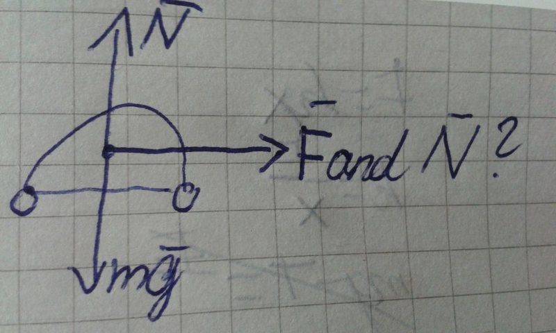

A car is being pulled by another car by a rope ( stiffness = 10 000 N/m) with acceleration of 0.3 m/s2.. Find the change in length of the rope.
F = ma
F = kx (x is the change in length)
x = F / k
I am having trouble at finding F. I have made a graph, which I have uploaded here, of the car that is being pulled in this situation and I don't know if it's correct. A hint would be appreciated.
Welcome to Physics Forums.
Here is a hint: There is only one horizontal force acting on the car being towed and that force is what is causing it to accelerate. The weight of the car is a downward force and the normal force is upward. So use one of the "relevant equations" that you listed.
Likes Arquon
So F should be 540 N ( since there is only one horizontal force, got it simply by F = ma) , or is there something else I'm not noticing ? Because I'm not getting a correct answer. It's supposed to be 0.011 m, but I get 0.0054 m, so F should be approximately 1100 N.
Well, unless there's something I'm not noticing also, I don't see how you did anything wrong. But I got 0.054 m, instead of 0.0054 that you got. That may have just been a typo. Sometimes the "correct answers" are wrong.
Likes Arquon
You may just want to check that you copied down all of the information from the problem correctly.
Likes Arquon
I forgot one 0 for k: it's supposed to be 105, my bad. And it seems I lost one bit of information while translating this exercise, so I will re-do it:
Car A is being towed by car B with a rope ( k = 105) and acceleration of 0.3 m/s2. Car A has a mass of 1800 kg. Ignore friction. Find the change in length of the rope.
Likes TomHart
It's definitely 0.0054m, unless you forgot to mention it is going uphill.
Likes CWatters and Arquon
No, it's going horizontal. Maybe car B has something to do with it ? If I imagine right, car B has 2 horizontal forces: one in direction of the rope, and another one to the front of the car B.
Edit : Although, nevermind. That still got me back to F = ma. I guess the answer is 0.054 m then. Thanks for help !
