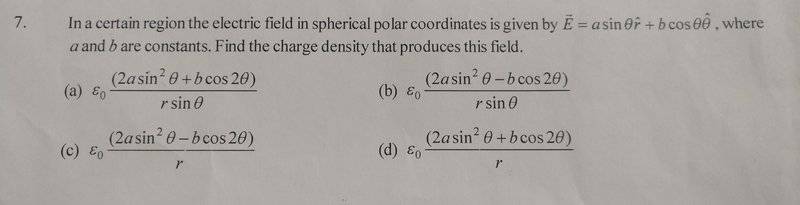

Finding the charge density that produces a specific field
In summary, the conversation is about using Gauss's Law to solve for an unspecified type of charge density. The person asking the question is unsure if their choice of surface charge density is correct and is considering using Gauss's Law in differential form instead.
Neolightdraco
[/B]
Using Gauss law,
Since there has been no mention of which type of charge density we have to find out I assumed it to be surface charge density since Gauss Law is in surface intergration , and I don't think there is any need to doing integration since the options given are results obtained without integration , I just can't get what's wrong
Is the problem in my choice of charge density or my method of solving it wrong?
