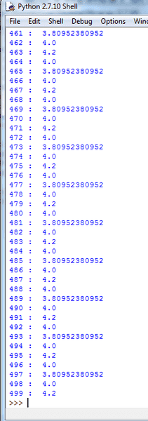

Find the closed form of the impulse response of the system [itex]y[n] = 7y[n-1]-12y[n-2]+x[n][/itex] using the peel away and guess method. Ie, by using Python code to find the geometric ratios and amplitudes of the outputs as n grows large, then calculate residuals, and find the geometric ratios and amplitudes of the residuals, and so on.
[/B]
This is the code:
Code:
memo = {}
def f(n):
     if n <= 0: return 1.0
     if n == 1: return 7.0
     if n in memo: return memo[n]
     memo[n] = 7*f(n-1) - 12*f(n-2)
    return memo[n]
# residual
def g(n):
    return f(n) - 4*4**n
for i in range(1,500):
    print i, ": ", f(i)
    # this closed form found from transfer function
    print i, ": ", 4*4**i - 3*3**i
I was able to find an exact matching closed form for the system from performing partial fraction decomposition on the transfer function H(z) and then doing inverse Z-Transform on that...but I did this as a last resort.
My problem was that when I check the ratio of the residuals, when n gets above 127, the ratios of the residuals don't stabilize, they oscillate.
This code:
Code:
    print i, ": ", g(i)/g(i-1)
produces this output at large n:
imgur link: https://i.imgur.com/CTukJxO.png
I spent a long time trying to reconcile this in a closed form. As you can see, this pattern goes [itex]4*1.05^{-1}, 4*1.05^0, 4*1.05^1, 4*1.05^0,...[/itex]. This seemed very messy.
Of course, the real closed form is simple enough when figured out from the transfer function, it's [itex]y[n]= 4*4^n - 3*3^n[/itex].
And below n = 127, the ratio of the residuals seems to want to settle around 3, so guessing 3 at that point would be fine.
Why are the residuals oscillating like that? Why doesn't it affect or appear in the actual closed form? How would one go about making a judgement on which value for the geometric ratio of the residuals to guess? If I had kept going with the later oscillating ratios of the residuals, wouldn't I have to introduce imaginary numbers?

I believe the numbers you are seeing result from doing arithmetic on very large numbers, too large for the computer to represent exactly.
For example, when i = 46, f(i) is approx. 1.98 X 10^28, and 4 * 4 ^ 46 is a 29-digit number. For larger i, the values get even larger. From about i = 121, the ratio of the residuals are probably at the limit of the computer's ability to do precise division, which, I believe, leads to the oscillation that you're seeing.
Likes kostoglotov
If Mark44 is correct, you might try setting your initial conditions to 1 and 7 rather than 1.0 and 7.0. Python has a built in big integer class that I think it will use if you do that.
Likes kostoglotov
Mark44 said:
Above, your equation is ##y[n] = 7y[n-1]-12y[n-2]+x[n]##, but your code below uses ##y[n] = 7y[n-1]-12y[n-2]##; i.e., no x[n] term. Why do you have this descrepancy?
The x[n] is there as an impulse at time 0 and 1, at t = 0 the impulse is 1 and t = 1 the impulse is 7.
Code:
