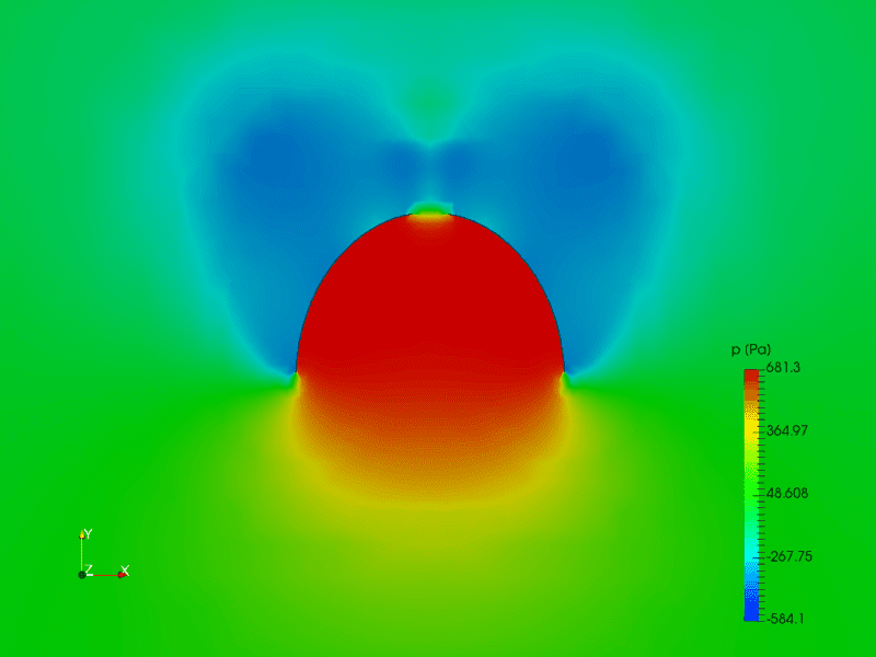

0.4 m skirt diameter .
33 m/s
From results : Drag force = 126 N and effective Cd = 1.6
