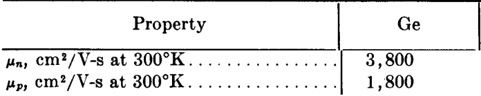

I am not sure if the question in the link is correct, because if you see
The above are the standard values at 300K as per the book. But in the actual question it does not mention the exact temperature, it only says at the temperature of the sample.
I can’t suggest anything else.
However, I will note this. You have both donor and acceptor atoms added. It is not clear to me what will happen. I suspect they will partially ‘cancel out’, the net effect being the same as simply adding (10¹⁴ - 7x10¹³ =) 3x10¹³ donor atoms/cm³.
EDIT: The above is supported by the statement from https://inst.eecs.berkeley.edu/~ee105/fa05/handouts/discussions/Discussion1.pdf
“If we assume complete ionization and if Nd-Na >> ni, the majority carrier electron concentration is, to a very good approximation, just the difference between the donor and acceptor concentrations”
