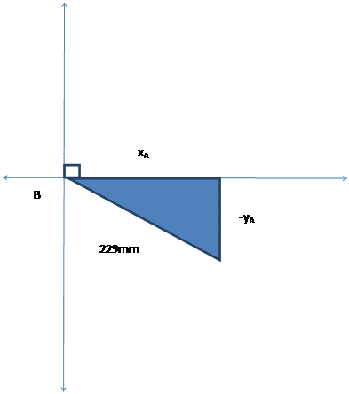

Are you considering point B to be your origin?
In that case, you can draw a right triangle with hypotenuse of length 229mm, and determine the angles (B-90), 90, (180-B). From there, the calculations are 229mm(sine ) and 229mm(cosine). Then be sure to orient your vectors in the proper direction.

You use the lengths of the sides and a little geometry to determine the coordinates. The (x,y) coordinate of point A is not just going to appear. You definitely should make a sketch of your triangle before working out the location of point A.
Alison A. said:
B is my origin because it is fixed in place and when the forces aren't exerted on AB or the spring the hinge swings open with B fixed in place. I don't get what you mean when you say
You have the angles:
B = 138.128 degrees.
If you draw the x-axis, you will see that the right triangle formed with B, A, and the axis will have one angle measuring (138.128-90)degrees.
The hypotenuse is equal to 229mm according to your drawing.
Then use sine = opposite / hypotenuse to solve for the y component (negative) and cosine = adjacent/hypotenuse to solve for the x component.

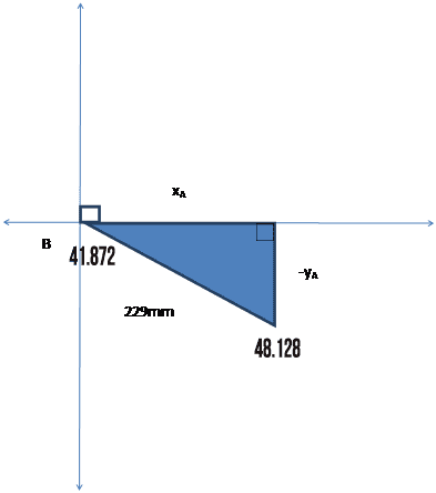

Why would 48.128 be down there? Wasn't that part of angle B? 90+48.128 = 138.128.

I don't know, I was trying to do what you mentioned before about (B-90), 90, (180-B)
You shouldn't just blindly put the angles in. Use what you know. If the angle at B was 138.128, and you just keep the part that falls below the x-axis, how much is left?

I didn't think I put them in randomly... Did we cut the triangle in half somewhere? I'm still not sure how we got this right triangle.
EDIT: So the part that is still at point B would be 138.128-90 right? Do I just have the numbers switched?

Your edit is right. We didn't move anything, just ignored the first 90 degrees of the angle to make a right triangle below.

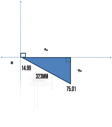

Alright, I got the problem wrong too many times so now I have new values. B is now 104.99. I tried taking sin(90)/323 = sin(14.99)/-y, making y -83.544 but that wasn't right...

I don't know... I'm so confused... I can find the angle of B by law of cosines
(323)^2=(169)^2+(235)^2-2(169)(235)cosB
B = 104.99 degrees
From here, I really have no idea.

It's not a new question... I answered it too many times so they changed the values. I don't need help with Part A I have already done it as you can see by the check mark.
Alison A. said:
You had the right method but the wrong hypotenuse. In the diagram, the hypotenuse of this right triangle is the fixed rod (235mm) not the spring.
