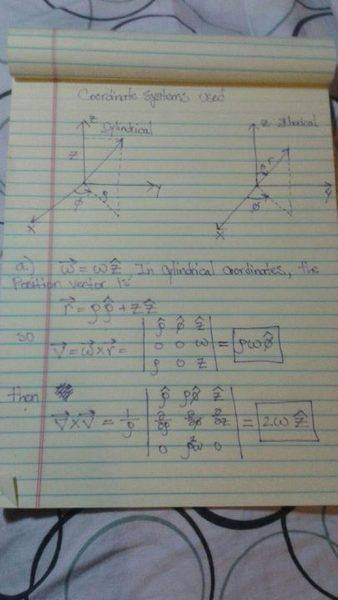

The angular velocity vector of a rigid object rotating about the z-axis is given by
ω = ω z-hat. At any point in the rotating object, the linear velocity vector is given by v = ω X r, where r is the position vector to that point.
a.) Assuming that ω is constant, evaluate v and X v in cylindrical coordinates.
b.) Evaluate v in spherical coordinates.
c.) Evaluate the curl of v in spherical coordinates and show that the resulting expression is equivalent to that given for X v in part a.
The expressions for the curl in cylindrical and spherical coordinates. Since I don't know how to put the determinant here ill just leave them out.
For spherical
x = r sinθ cosΦ
y = r sinθ sinΦ
z = r cos θ
So I worked out part a correctly (I think) which is in the attachment, but I'm stuck on part b.
b.) So for this part I have to convert ω to spherical coordinates. Since ω only lies along the z-axis, that means that Φ and θ are equal to zero, so
ω = ω r-hat
and the position vector in spherical polars is
R =
r r-hat
so that means that when I cross ω and R I get zero, I don't know what I'm missing.

part (a) looks good.
ω = ω r-hat
Go to an arbitrary point in space and try to write ω in terms of the unit vectors ##\hat{r}##, ##\hat{\theta}##, and ##\hat{\phi}## at that point.

I can't really picture it in the way you're asking me too. What if I substitute z-hat = r-hat cosθ - θ-hat sinθ?
Yes, that's it.
