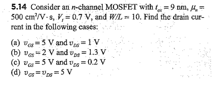

The equations provided require the oxide permittivity (εox)as well as the oxide thickness (tox) to determine the gate oxide capacitance per unit squared (Cox). How to solve this?
In triode region: ID = μn * Cox * W/L * ((VGS-Vth)* VDS - VDS2/2
In saturation = μn * Cox * 1/2 * W/L * (VGS-Vth)2 * (1 + λ*VDS)
Cox = εox / tox
Without εox, I can't get Cox; I can't start.
tox is given. εox you should be able to look up. Assume the device uses silicon dioxide as the gate dielectric.
