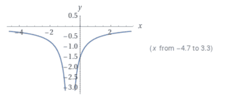

Find the vertical asymptote of ##y=\frac{2x-5}{\left|3x+2\right|}##. If there is an infinite limit, what direction does it go in?
Note: I'm currently only at the stage of using the informal definition of limits ("Calculus, a complete course" by Robert A. Adams, chapter 1.3, 9th edition, problem 34, to be exact), so I'm looking for help without using the epsilon-delta method
Since ##\left|3x+2\right|=0\rightarrow\ x=-\frac{2}{3}##, we know the vertical asymptote is at ##x=-\frac{2}{3}##.
Looking at the limit at that point, and also looking at the left- and right-sided limit, I cannot simplify it any further: ##\lim_{x\rightarrow-\frac{2}{3}}{\frac{2x-5}{\left|3x+2\right|}}=\lim_{x\rightarrow-\frac{2}{3}\pm}{\frac{2x-5}{\pm(3x+2)}}##.
That being said, is there an easy way to find out whether the limit is going towards infinity, and which direction the infinity goes? Or should I be expected to be able to quickly visualize what a graph of a function looks like, and determine from there which direction the graph goes? Right now, I just plotted it using computer software to see that the direction of the limit goes towards negative infinity, see attachment. However, Is there a method to quickly determine this without using software?
Thank you!

You can just try ##x## slightly less than and slightly greater than ##-\frac 2 3##.

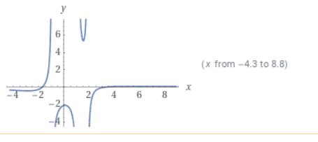

Lets just do the more 'extreme' example, I could relatively easily figure out where the vertical asymptotes of ##y=\frac{x^4-3x^3+3x-19}{x^5-9x^2+9}## would be, but how would I know which direction they would tend to for each asymptote?

Replacing ##|3x+2|## with ##\pm(3x+2)## is a bad step if you take it literally. The ##\pm## means that the denominator can be positive or negative, but you know that ##|3x+2|## is always positive. You should not lose track of that.
Because the denominator, ##|3x+2|##, is always positive, you know that the sign of the original fraction will be the same as the sign of the numerator at ##x=-2/3##. It is ##2 (-2/3) - 5 = -19/3 \lt 0##.

Most cases should be straightforward, like this one. The only complication comes if the numerator changes sign close to the asymptote. And, where the zeros of the numerator are not easy to calculate. In those cases, which you are unlikely to face, you'll have to rely on your wits and numeracy skills.
To be precise, you are unlikely to see hard cases in typical homework problems. The real world can be messier. One thing that you might run into in homework is the situation where both numerator and denominator have zeros at the same x value. The class will probably explain what to do in those cases.
