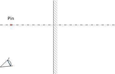

Do you have the means to make a drawing of the situation and post it ?
My perception so far is that the pin is vertical and parallel to the mirror, so a top view would be a good start.
BvU said:
Hello again,
Hello BvU. I'm unable to get a picture posted but I can describe it ... just a mirror with a bit of vertically orientated string sitting a few centimetres in front of it

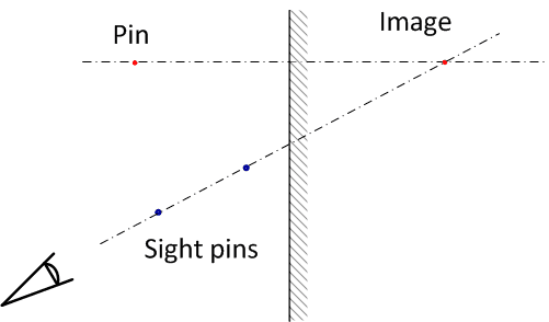

Well, it's not exactly Disney quality, but this is what I imagine:
Observer sees pin in mirror and places two pins,
then moves a bit and repeats. Right ? Try to guess four reasonable pin positions and we'll pick up from there.
(It all being geometry then)
Q1 should be easy to answer !

And here's the next step, the first two pins. I also drew the sight line. Your turn to draw another sight line
Start to see some geometry ?

In the drawing there is now one original pin and two sighting pins. Your exercise wants two more sighting pins. Surely you understand the principle ? If you want to measure a distance to something you can't reach (because it is on the other side of a canal or a mirror), then you draw two straight lines in the direction of the something from two different starting points and where the two lines cross is where the something is located. And two points are enough to uniquely define a straight line ! You don't have to jump into the canal or the mirror and still can say exactly what the position of the something is !
Your turn to place two more pins (didn't I ask that before ... ? )

I draw the top view, so you see the head of the pin. The word string isn't meaningful to me, unless it's the shaft of the pin, sorry.

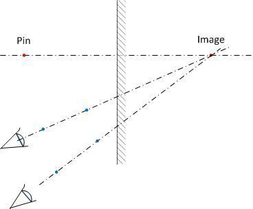

They want you to move the observer eye a bit and place two more pins on the new line to the image.
If you then remove the mirror (leaving a line where it was on the table for Q2) you can place a pencil on the crossing point: that's where the image was.
Take a mirror and five pins and see it work !

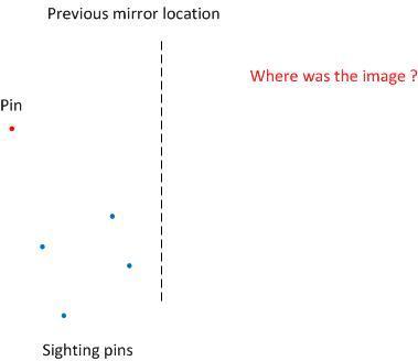

To get you going again (how come you were so tenacious with the resistance graph and gave up on this one ?) :
Is what I meant with moving the observer eye a bit and placing two more pins. Then you take away the mirror (leaving a pencil line where it was located) and you have the five pins lefte over on the table (or whatever):
Now what can the student (why is it always a female in your exercises ?) do to reconstruct the position of the image ?
Please tell me it's easy now ...
Th student draws lines up to the mirror the takes the mirror away. Then continues to draw the lines further along and where they cross is the point of the IMAGE..
Voila?
Is that the answer?
Sorry, I missed this alert. Yes. Simple, isn't it ?
