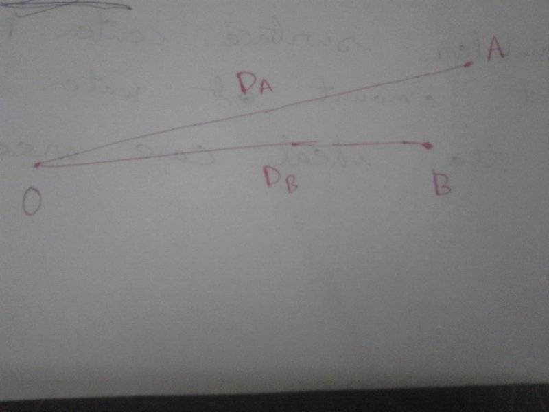

Lets suppose that two points A and B are very close together compared to their distance from an observer who is very far. Suppose the distance from observer to point A is DA and to point B is DB. How precisely we can find the distances separately.

Can you illustrate what you mean with a sketch ?
Yes, i will.

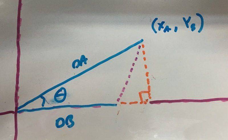

Are you trying to simply determine the distance between A and B based on known angle of separation between them and known distances? You can know that exactly using pretty basic geometry.
I would set DB to be your x axis, then use trig to figure out (XA, YA).
The orange vertical is YA.
The orange horizontal is then XA - DB.
The pink line is found using the Pythagorean theorem.

Yes, its kinda like this, but if the error in measurement of DA and DB is higher than their separation, then will we be able to find outt their actual seperation? so i wanted to know how precisely we can measure DA and DB
No, if you turn those values into variables, then the equation can only be made to provide a range.
Find the values for DB and DA that place them closest together and those that place them furthest apart. That's your range.

I got my answer here. thanks
