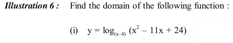

Find the domain (and range) of ##y = \log_{(x-4)}(x^2-11x+24)##
Given the function ##y = \log_a x##, we have the following domain ##x>0## and the base ##a>0\quad (a\ne 1)##. The range of the function ##y\in \mathbb{R}##.
Problem statement :
I copy and paste the problem from the text. You will note that I added the range myself, because it seemed relevant and yet I couldn't do it.

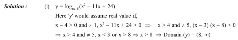

From ##(1)\;\rm{and}\;(2)##, we have to reject ##\cancel{x<3}##. Also ##(1)\;\rm{and}\;(2)## must hold simultaneously, similar to an ##\rm{AND}## in between them. That leaves us with ##\boxed{x>8}## as the domain, or writing it nicely : ##\text{Domain of}\; y\mapsto \boxed{x\in(8,\infty)}.\quad \huge{\color{green}{\checkmark}}##
This agrees with the solution in the text. The typing is poor and incoherent at places. For one, I didn't understand why the authour said ##x\ne 5##, though of course it isn't. That way, ##x\ne 6## too.

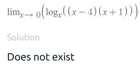

Evaluating online, I find that the limit does not exist, presumably because it's ##-\infty##?

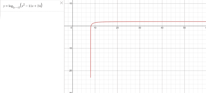

On the other extreme, it seems that the limit is 2.
Here is the graph from ##\texttt{Desmos}##. The range of the function turns out to be ##\boxed{y\in(-\infty, 2)}##
Request : A hint as to how to evaluate the limit of the function ##\displaystyle{\lim_{x\to 0} \log_x (x-4)(x+1)}##.
When [itex]x = 5[/itex], the base of the logarithm is 1. Is that possible?
Alternatively, you can use [tex]
\log_{(x-4)} f(x) = \frac{\ln f(x)}{\ln (x - 4)}[/tex] and the denominator vanishes when [itex]x = 5[/itex].
