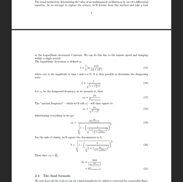

I ended up doing this:
I don't understand your thinking in equations 15 and 16.
In 15, T is the dampened period.
How is ξ defined?
Working backwards, you seem to be claiming that the frequency ratio is δ2 : δ2+4π2. I don't see why that would be.
https://en.wikipedia.org/wiki/Logarithmic_decrement
It's mainly based on that article and a message I got from someone:
For small amounts of damping, as in this experiment, it doesn't really matter if the damping force is proportional to the velocity or not. The important quantity is the amount of energy taken out of the system per cycle of oscillation. You can measure that from the rate of decay of the amplitude and convert that to an equivalent linearized damping constant, and estimate the shift in resonant frequency. In practice, you will only measure a significant amplitude decay over several days, and the frequency correction will be most likely be negligible compared with other sources of error. Google "logarithmic decrement" or "log dec" for the way to convert the amplitude decay into a damping parameter.

haruspex said:
If you follow the link through to https://en.m.wikipedia.org/wiki/Damping_ratio, you will see that the derivation depends on the differential equation you were at pains not to depend on.
Yeah, I found that too. But I like this because it shows a different angle of the situation, which is what I was attempting to do. Doing mechanics without differential equations is like doing special relativity without lorentz transformations, it's just not happening. But that doesn't mean you can't find another way in the system to broaden your knowledge and find another connection of which you didn't know before ^^

Fair enough, but personally I find solving the differential equation to get the exponential decay gives insight into the process, whereas quoting equations as in post #9 conceals it.
I agree. The derivation gets a little hairy though, and already got 5 pages of those, so I decided to keep it out for now. I can always add it, but that's a lot of work which is time I'll have to pay for somewhere else. Usually I derive everything I use, even little things such as the inertial moment of a sphere or bar.
So in short: I agree, but things are getting a little too long in the assignment :P
