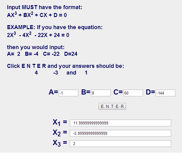

Oh yeah. But sill I used the values you got and I checked with an online cubic calculator, and this is what I got
The answer is quite close. x1 should be 12 and x2 should be -6.
can you explain why this is so??
