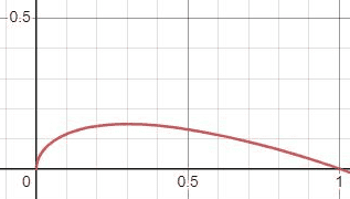

Ok, so i have done many math classes, as i am an engineer, however, a theory class and proof class i h ave not done, except maybe one haha.
here is my question, if i draw some sort of curved line by hand, how do i find an equation for that?
for example, i draw half of a tear drop but along the horizontal (like the posted image). How would i find the equation of that line, preferably without a computer? im just wanting to see how this was done back in the past.

For this I would just guess a functional shape, with some constants to tweak it to fit data if you have it.
$$ y(x) = \sqrt{x} - x $$
Plot it?
Otherwise, you could use the data from the drawing to do Fourier Transform. They can draw anything with those.

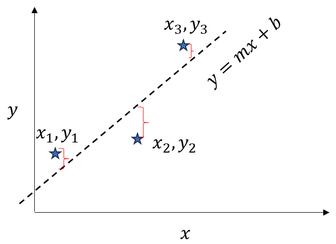

The basic idea for the Method of Least Squares:
You have some data points ##( x_1,y_1),(x_2,y_2),(x_3,y_3)##
Say you want to fit a linear function of the form ##y = mx+b## to the data.
You have 2 parameter to adjust ##m##, and ##b## in that form ( If you want to try to fit a different form, like ##y = ax^2 + bx + c##, you have more free parameters that can be adjusted, etc..).
You begin by forming the total squared error. That is some measure of "how far"(just magnitude -hence the squaring) the ##y## value of the function is off from the data when it is evaluated at the independent coordinate of a particular point:
We would have above:
$$ f(m,b) = ( y_1 - (mx_1+ b))^2 + ( y_2 - (mx_2+ b))^2 + ( y_3 - (mx_3+ b))^2 $$
From there you optimize ##f(m,b)## using standard techniques from multivariable Calculus, namely:
$$ \frac{\partial f }{\partial m } = 0 $$
$$ \frac{\partial f }{\partial b } = 0 $$
Are solved simultaneously for the parameters ##m## and ##b## that minimize the sum of squared error i.e. ##f(m,b)##.
For a full explanation you'll be best to search the term "The Method of Least Squares", I just wanted to give you "the flavor" with a basic example.

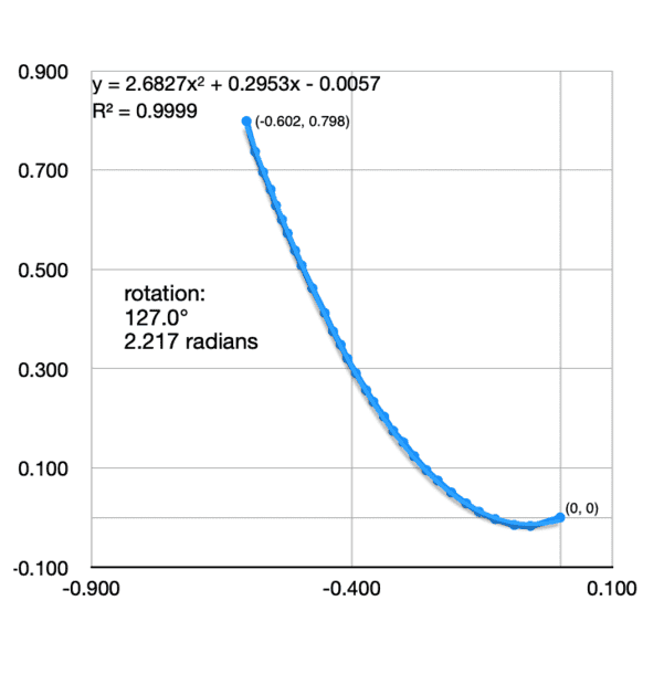

It looked like a parabola to me so I digitized the curve and rotated the points until my spreadsheet maximized the R² value for a parabola. Almost perfect @ 127°.

I suppose if I were stuck on a deserted island without a laptop, I could solve for 3 points picked from the parabolish curve, and solve with simultaneous equations:
given​
given​
x​
y​
ax²​
bx​
c​
y​
-0.057​
-0.017​
0.0030​
-0.057​
1​
-0.017​
-0.41​
0.32​
0.17​
-0.41​
1​
0.320​
-0.60​
0.80​
0.36​
-0.60​
1​
0.798​
matrix math​
curve fit​
a​
1​
2.77​
2.68​
b​
1​
0.330​
0.295​
c​
1​
-0.00724​
-0.00571​
R² =​
0.9996​
0.9999​
Mathematically a bit less accurate, but visually identical.

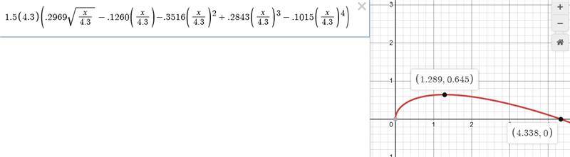

i have been messing around with desmos and started to add functions together. y=sqrt(x) -x -x^2 and things like this. but y=sqrt(x)-x produces a nice curve, then i went all fancy from an equation found in my airfoil design book. How the heck did they discover this equation back in the 50's before computers could do this? thats what i want to know? i feel so lazy when i use a PC haha
