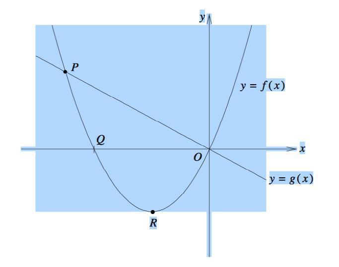

The sketch on the previous page shows the graph of a function f, which is a parabola with vertex R, and the graph of a function g, which is a straight line defined by g(x)=-(1/2)x. The graphs of f and g intersect at P and O(the origin). The function f is defined by:
f(x)=ax2+bx+c
Df=ℝ, Rf=[-2,∞) and b/(2a)=2.a)Find the coordinates of R.
g(x)=-(1/2)x
f
(x)=ax2+bx+c
if b/(2a)=2 then my x coordinate of the vertex = 2 correct? but on the graph it looks more like -2
Is this due to the missing (-)b
I am stumped on this question, I am sure It is quite obvious but I would appreciate a point in the right direction.

If b/(2a) = 2, then b = 4a, so you can rewrite f(x) = ax^2 + 4ax + c. This has a minimum where 2a x +4a = 0, or where x=-2. So your original insight was right, but you might have tried to jump a logical step and missed where the negative belongs.
How can you tell what the y coordinate might be?

That is the picture:
Likes Jaco Viljoen and SammyS
Rf={-2,∞)
so y=-2
so my vertex is (-2,-2) (Coordinates of R)
f(x)=1/2(x+2)^2-2

Find the equation of a line that is parallel to the straight line and passes through R.
y=-1/2x+0 point R(-2,-2)
y=mx+b
-2=-1/2x+b
-2=-1/2(-2)+b
-2=1+b
b=-3
y=-1/2x-3
Likes EM_Guy
Find the coordinates of P
(1/2)x^2+2x+0=-(1/2)x+0
(1/2)x^2+2x+(1/2)x=0
(1/2)x^2+2&(1/2)x=0
(x^2)/2+(5x)/2=0
x^2+5x=0
x(x+5)=0
x=0 and x=-5
so (-5,?)
y=-1/2(x)
y=-1/2(-5)
y=2.5
so P (-5,2.5)

Calculate the distance between P and Q
P(-5,2.5) Q(?,0)
Find Q
x intercepts:
y=(1/2)x^2+2x+0
((1/2)x+2)(x+0)
(1/2)x=-2 and x=0
x=-4 and x=0
Q(-4,0)
d=√{(x2-x1)2+(y2-y1)2}
d=√{(-4-(-5))2+(0-2.5)2}
d=√{(-4+5))2+(0-2.5)2}
d=√{12+(-2.5)2}
d=√{1+6.25}
d=√{7.25}
The distance between P and Q is √{7.25}

Calculate the maximum vertical distance between corresponding points on the graphs of f and g on the interval[xP,0], where xP denotes the x-coordinate of P.
Jaco Viljoen said:
I do not understand the following question, some help please.
The vertical distance between the line and the parabola is ##h = -\frac x 2 - \frac{x^2}{2} - 2x##. This distance function turns out also to be a quadratic, so you can find its maximum value by techniques you already know.

how do I determine which function is greater than the other?
I am not sure I understand what is expected of me?
P is an intersection, so there is no difference in hight?
Surely the max vertical distance will be at the vertex or somewhere to the right?
Am I misunderstanding this?
The graph you posted earlier clearly shows that the line is above the parabola for the interval in question.

g(x)-f(x)=d(x)
g(x)-f(x)
d(x)={(-1/2)x}-{(1/2)x^2+2x}
d(x)=(-1/2)x^2-2&(1/2)x
x=-b/2a
x=(-(2&1/2)/(2(-1/2))
x=-2.5
d(x)=(-1/2)(-2.5)^2-2&(1/2)(-2.5)
d(x)=3.125 maximum vertical distance
Mark44 said:
I think the max. vertical distance is at some point to the left of the parabola's vertex. I worked it out several days ago, but have since thrown away my work, so I'm not absolutely certain of this. I gave a hint in post #17, so take a look at that one again.
Hi Mark,
Does this look correct?
Jaco Viljoen said:
g(x)-f(x)=d(x)
g(x)-f(x)
x=-b/2a
x=-2.5
Yes, this looks fine.
