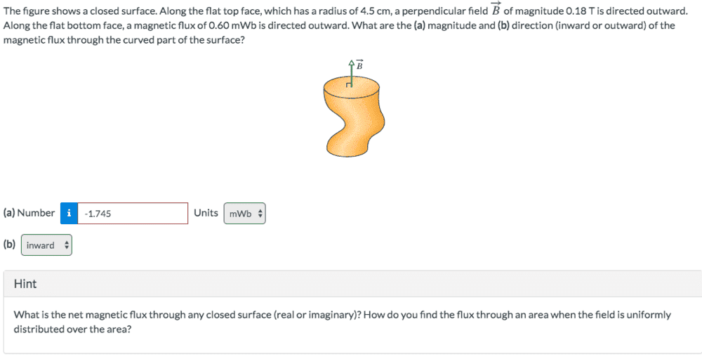

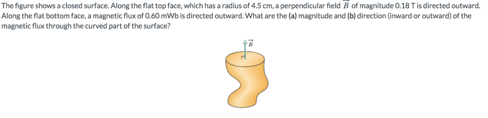

The figure shows a closed surface. Along the flat top face, which has a radius of 4.5 cm, a perpendicular field of magnitude 0.18 T is directed outward. Along the flat bottom face, a magnetic flux of 0.60 mWb is directed outward. What are the (a) magnitude and (b) direction (inward or outward) of the magnetic flux through the curved part of the surface?
Flux on a surface = 0 (by Maxwell's equations)
I have this problems I am trying to figure out:
So I know that $$\int B\, dA = 0 = \phi_{total}$$
$$\phi_{total} = \phi_{bottom} + \phi_{top} + \phi_{side} = 0$$
$\phi_{side}$ must be equal to the other two fluxes, since they are both outwards:
$$\phi_{side} = \phi_{bottom} + \phi_{top}$$
$$\phi_{side} = 0.6*10^{-3} + \pi*(0.045)^2*0.18=1.745Wb$$
However, I am getting that 1.745Wb is the wrong answer. Does anyone know why?

Your approach looks OK to me.
What did you get regarding the "inward" vs "outward" part of the problem?
For what it's worth, there is a convention that is sometimes used that states outward going flux is positive and flux directed inward is negative. I'm not sure if that applies here though since the problem statement just says "magnitude." (So I'm assuming that the expected "magnitude" part of the answer is non-negative.)

So, I actually got the direction of the magnetic flux through the curved part of the surface correctly (inward). However, this shouldn't matter for the magnitude of the flux as long as I treat the flux of the side a different direction from the flux on the top and bottom. I don't understand why I am getting the magnitude incorrectly.

Try mWb!

That's it. :smile: (or bring back the "[itex] \times 10^{-3} [/itex]" that got lost somewhere in the submitted answer.)

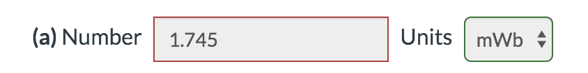

tried doing mWb (both 1.745 and -1.745), but still wrong:
You are quoting more digits than in the given data. Try rounding to 2 or 3. Beyond that, I give up.

that shouldn't be a problem because there is a margin of error of 2% for answers.

Then we are down to guessing the error in the question. Maybe it was meant to say that both flat faces have a flux upward.
I also put the negative value, and it was wrong:

No, I am suggesting that of the two fluxes through the flat surfaces it is supposed to say that one is in and the other out.
