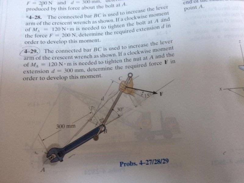

The connected bar BC is used to increase the lever arm of the crescent wrench as shown.If a clockwise moment of Ma=120 N*m is needed to tighten the nut at A and the extension d=300mm, determine the required force F in order to develop this moment.
M=Fd
Wrote the x length of BC by multiplying 0.3m*cos30, then took the x-y coordinate system through the AB(for x) and perpendicular to the AB(for y).Tried to find the angle that F makes with the x-y (ABCx), found it as 45, but the result is not correct.

Your method looks ok, so please post the details of your working.
I solved it, found the angle between my x-y then I multiplied Mx and My.When I tried to do it I wasnt adding the My.That's why my result was incorrect.I also found another method by finding the distance from A to C.Thank you for your reply.
