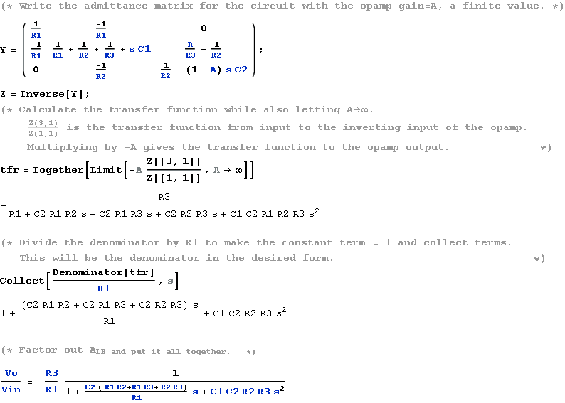

You have now got the correct answer. The attachment shows how I got the result using another method.

The Electrician said:
I see that now. It was late when I first looked at your work and I missed that point. :-(
Haha it's no worries at all! Thank you very much for your input and help, and that attatchment makes for a nice check! :smile:
