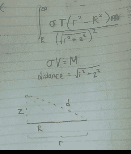

Okay, I'm starting to visualize it now, but I'm not sure how to put it into mathematics. I want to find the gravitational force for each concentric circle that has mass σπ(r2-R2) because V*σ=Msheet, and just using geometry the distance between the mass and the circles would be (r2+Z2)½, here's where I am:
However, I know that it's not correct mathematically because I'm not sure how to include dr, which I know is supposed to be in here. How can I make it a part of my integral? Or am I approaching this incorrectly?

The dr is included by putting the correct mass of the infinitesimal ring which is σ2πrdr.
Note also that only the vertical component of the force due to the ring is to be considered.

I'm not sure how to visualize it this way, but what you're saying is that my equation (inside the integral) should be ((Gσ2πr*m)/Z2)*dr? I used the second equation from #2 in my original post, m being the mass of the point and G being the constant. Why is the equation for circumference instead of area used? I made the integral from R to ∞, which I believe is correct, right?
Because the element has to consist of a region for which d is roughly constant. That makes it an annulus of internal radius r and external radius r+dr. That has area 2πrdr.
