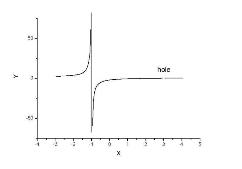

The function (x^2-5x+6)/( x^2-2x-3) does not have local extrema ( the derivative is nowhere zero).
Edit:
x=3 and x=-1 are not points of the domain. It is not true that the maxima are at 3/-1. The function is not defined at those points. It is a hole in the domain at x=3, and a vertical asymptote at x=-1. The function goes to infinity if x tends to -1 from left, and tends to - infinity, if x goes to -1 from the right.
With derivation, you will find that the function monotonously increases in its whole domain.
ehild
ehild: your graph looks wrong, the factor (x-3) is in both the numerator and the denominator, x=3 is just a hole in the function at that point - the only vertical asymptote is at x=-1.
Thank you mfb. I edited my post. I can not imagine how the program made that graph from the function.
ehild
