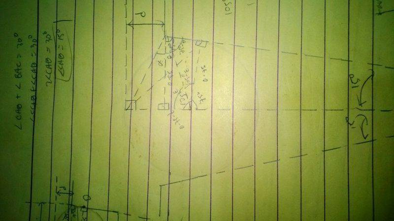

The machine tool diagram on the right shows a symmetric worm
thread, in which a circular roller of diameter 1.5 inches sits.
Find the amount d that the top of the roller rises above the
top of the thread, given the information in the diagram. (Hint:
Extend the slanted sides of the thread until they meet at a point.)
Unreadable and sizeways images? You have to be kidding. My suggestion would be to post a single readable image with the picture and labeled variables, such as ##\alpha##, ##d##, ##r##, and possibly others. Then write (type!) your solution in terms of known variables. So you get ##d = \text{ some formula}##. Only put in the values at the end. Then your solution would be readable and understandable.
[Edit, added]: Here's a picture:
Now, you know ##r,~a,~\theta##. Solve for ##d## in terms of them.

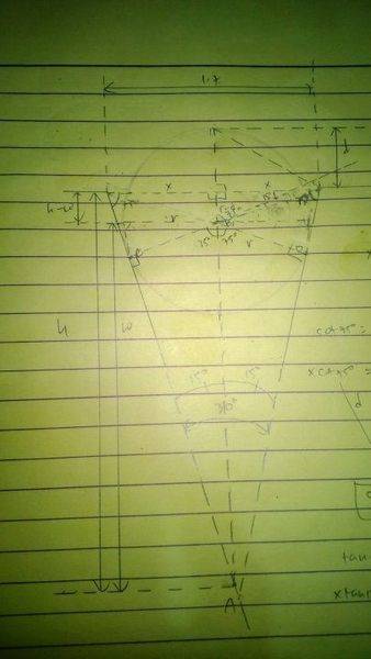

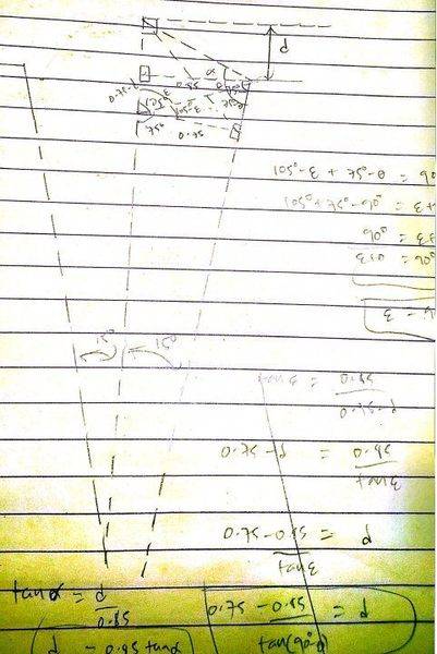

So we have r = 0.75, h = 3.1722 and w = 2.7990. In the end it will be r - d = h - w which would be d = 0.3768. I looked at the back of the book the answer is 0.476. And the reason is because r does not make a right triangle with w as its leg. There is a slight space with the circle and the symmetric thread. Look at the picture below:
Again, your image is impossible to read. And, yes, ##r## is perpendicular to its leg. You haven't shown readable equations (type them in here, don't post images) for ##h## and ##w## so I don't know what you are doing wrong. It doesn't help when you just post numbers. Using my figure, you should get ##w = 2.897## and ##h = 3.172##. This will get you ##d=.4755##.
[Edit, added:] I think I see where you may be going wrong. Notice that ##w## is the hypotenuse of the right triangle and use that.
