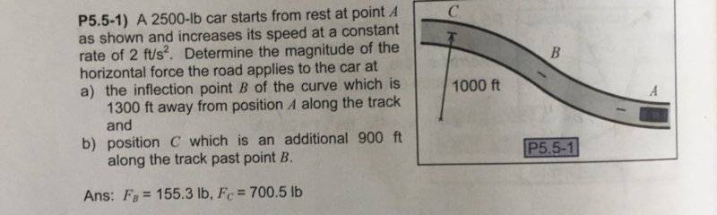

Given weight car = 2500lb, acceleration = constant = 2 ft/s^2, radius of curvature at C = 1000 ft, distance between A and B = 1300 ft, distance between B and C = 900 ft
Find horizontal force of road on car at B and C.

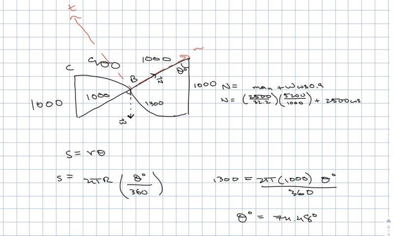

I tried using kinematics, since I've got constant acceleration, to find the velocity, in order to use that to find the centripetal force. From there, I'm trying to find the Normal force. I'm using normal tangential coordinate system. I'm having trouble recognizing the geometry of the situation, since I seem to need to know angles. I tried using the arc sector formula. The answer I'm getting is way off of the one shown below in the image.
(Ignore the cos(0.9), that's in radians by accident. I forgot to change that on the image)

The diagram gives one more important piece of info about B.

2500 lb is a weight yes. We'd divide by 32.2 ft/s^2 to get the mass. Is the extra piece of info pertaining to the inflection point?

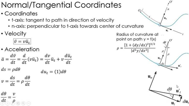

Here's my work showing the velocities and also what I mean by normal tangential coordinate system.
Yes.

Yeah, I think that's what my problem was. I wasn't using the correct radius of curvature. Would an arc-sector relationship formula be useful here to find that radius of curvature? I made an assumption that the radius of curvature would somehow be the same, even though it didn't feel right.
Do you know what a point of inflexion is?
Otherwise, which way is the centripetal acceleration between A and B, then which way is it from B to C?
What does that tell you about B?

Doesn't a point of inflection say something about symmetry?
Yes it does.
Sorry to dive in here but perhaps you are missing something obvious...
To calculate the force on the car (at any point) you need to know how it's accelerating rather than its velocity. The acceleration could be linear, centripetal or some combination of both. So what's the acceleration at B?
Not really. It just says that the curvature is changing sign.

it'll just say the acceleration (centripetal) is pointing inward, which will be different for both sides, since the curvature of the road changes. I knew this before. I'm having trouble calculating actual values because I'm unsure about angles and radius of curvature where it's not given (so for C it's given as 1000ft)

if the curvature is changing smoothly, has one sign for A to B, and the opposite sign for B to C, what is the curvature at B?

You don't actually need to know the radius before or after B to work out the acceleration at B. Think more about what an inflection point is. If the we were to call the radius before B positive and after B it's negative, what would the radius be at B?
