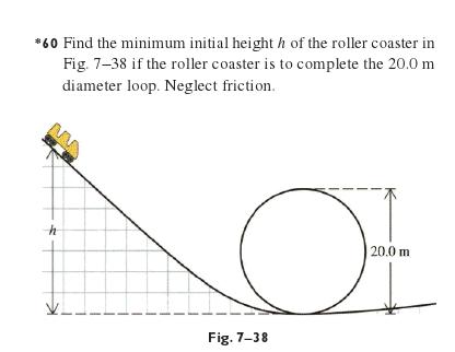

In summary, we are trying to find the minimum initial speed and height needed for a roller coaster to clear a loop without falling down. Using the equations for potential and kinetic energy, we can set up an equation to find the minimum initial height. To find the minimum initial speed, we can use the fact that at the top of the loop, the normal force is equal to zero and the centripetal force is equal to the gravitational force. By using the given diameter, we can find the minimum speed and then use conservation of energy to find the minimum initial height.

PE = mgh
KE = [itex]\frac{1}{2}[/itex]mv[itex]^{2}[/itex]
W = ΔKE
W = Fd
g = 9.80m/s[itex]^{2}[/itex]
hi = ?
hf = 20.0m
PEi + KEi = PEf + KEf
mghi = mghf
Would you then cancel the masses out? If you did, the initial height would be 20.0m. Am I right? Thanks in advance to anyone who helps.
In order to clear the loop, the roller coaster needs to be moving with some speed at the top, and thus have kinetic energy, otherwise it will fall down. Try to find the minimum speed necessary to have a nonzero normal force at the top of the loop. Hope this helps!

How would I find the initial speed, since I'm only given a diameter of 20.0m?
At the top of the loop, the centripetal force is the sum of the gravitational force and the normal force (both are directed radially inward). At the minimum possible speed necessary, the normal force at the very top of the loop will be zero. Therefore, the only component of the centripetal force is the gravitational force. Now, using the given diameter, you should be able to find the minimum speed necessary at the top of the loop, and then use conservation of energy to find the minimum initial height. Let me know if this makes sense.
