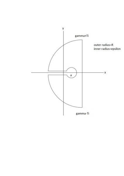

Find the inverse laplace transform: [tex] {\cal L}^{-1}\{e^{-\sqrt{s-a}c}\} [/tex]
where [itex] a [/itex] and [itex] c [/itex] are constants. [itex] s [/itex] is the complex variable.
Bromwich integral: [tex] \frac{1}{2\pi{}i}\lim_{T\rightarrow \infty}\int_{\gamma-Ti}^
{\gamma+Ti}e^{st-\sqrt{s-a}c}ds [/tex]
Residue theorem: [tex] \oint f(s) ds=\sum Res(f(s)) [/tex]
There is a branch point at [itex] s=a [/itex]. Also, there are no poles. Therefore, the sum of the residues is equal to zero. So I have a keyhole contour centered at [itex] a [/itex] with an outer radius of [itex] R [/itex] and inner radius of [itex] \varepsilon [/itex]. I chose [itex] \gamma=2a [/itex]. I attached a general image of the contour that I used. The contour is centered at [itex] a [/itex].
Therefore, [itex] s=Re^{i\theta}+a [/itex] along the the outer circle,
[itex] s=xe^{\pi i}+a [/itex] going from left to right along the branch cut,
[itex] s=\varepsilon e^{i\theta}+a [/itex] along the the inner circle, and
[itex] s=xe^{-\pi i}+a [/itex] going from right to left along the branch cut.
From Jordan's lemma the integral along the outer radius goes to zero as [itex] R\rightarrow \infty [/itex]. Similarly, the integral along the inner circle (keyhole) goes to zero as [itex] \varepsilon\rightarrow 0 [/itex]
Therefore,
{\gamma+Ti}e^{st-\sqrt{s-a}c}ds + \frac{1}{2\pi{}i}\int_{branch cut}=0 [/tex]
{\gamma+Ti}e^{st-\sqrt{s-a}c}ds =
\frac{-1}{2\pi{}i}\int_{branch cut}
=\frac{-1}{2\pi{}i}\lim_{\substack{R\rightarrow \infty\\\varepsilon\rightarrow 0}}
(\int_{-R+a}^{-\varepsilon+a}e^{st-\sqrt{s-a}c}ds+
\int_{-\varepsilon+a}^{-R+a}e^{st-\sqrt{s-a}c}ds) [/tex]
[tex] = \frac{-1}{2\pi{}i}(-\int_{a}^{\infty}e^{(a-x)t-\sqrt{x}ic}e^{\pi{}i}dx+\int_{a}^{\infty}e^{(a-x)t+\sqrt{x}ic}e^{-\pi{}i}dx) [/tex]
[tex] = \frac{-1}{2\pi{}i}(\int_{a}^{\infty}e^{(a-x)t-\sqrt{x}ic}dx-\int_{a}^{\infty}e^{(a-x)t+\sqrt{x}ic}dx)
=\frac{e^{ta}}{\pi{}}\int_{a}^{\infty}e^{-xt}\sin{(\sqrt{x}c)}dx [/tex]
And this is where I'm stuck. I think this integral doesn't have a closed form. I can expand the integral into an infinite series but I don't know how to integrate the terms. I tried doing the Inverse Laplace transform in mathematica. The answer it gave me is:

Your analysis is correct as I see it except you're not integrating over the correct bounds. If [itex]z=a+re^{\pi i}[/itex], what must the lower limit on r be in order to reach a?

From similar steps as in the first post and letting [itex] u=s-a [/itex] I get the final integral
{\gamma+Ti}e^{st-\sqrt{s-a}c}ds =\frac{e^{ta}}{\pi{}}\int_{0}^{\infty}e^{-xt}\sin{(\sqrt{x}c)}dx [/tex]
I evaluated the integral with mathematica and it agrees with what i got by just taking the inverse directly with mathematica. The only thing it is a conditional expression valid with t>0. But doing the inverse directly it doesn't give that condition... thoughts?
jackmell, is this what you were referring to? that the limits should be from zero to infinity? I'm not sure how u figured that out without making the substitution. Without making the substitution [itex] z=a+Re^{\pi i} [/itex]...[itex] z [/itex] goes from [itex] -R+a [/itex] to [itex] -\varepsilon+a [/itex]. Then taking the limit as R goes to infinity and epsilon goes to zero aren't the limits from a to infinity?
ray, so what ur suggesting is to do a substitution...I saw the constant outside the square root and had immediately thought it didn't match with the table...lol guess i made this problem more complicated than it needed to be. -_-;
So out of curiosity how would I evaluate this final integral? I can do a series expansion...but i don't know how to integrate the individual terms.
Assume a is on the real axis for simplicity, then you're integrating over a branch-cut [itex](-\infty,a)[/itex]. Ok then, if I let [itex]z=a+re^{\pi i}[/itex], and [itex]z=a+re^{-\pi i}[/itex] like you and I both did for the analysis, and let r go from [itex](\infty,0)[/itex], does not z traverse over that entire branch-cut except for the indentation around the branch-point?

ohhh, i get it. i didn't change my bounds when I did the substitution! thanks.
