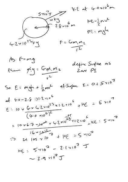

I have not tried it with a different zero PE at the centre, but outcome should be the same..
As you know, the position at which you assume the potential energy to be zero is arbitrary, however some zero locations make understanding the physics a little more straightforward. The usual procedure in space flight analysis is to set the potential energy equal to zero at an infinite distance from the center of a large mass. Which when you look at the expression for potential energy makes perfect sense. This potential energy function leads to a gravitational potential energy well which must be overcome by a sizable amount of work to escape from a large planet. As you have calculated, energies of the order of 10^7 Joules.
I am a bit confused.. are Ella1777 and MartinCarr the same person? I shall assume so.
