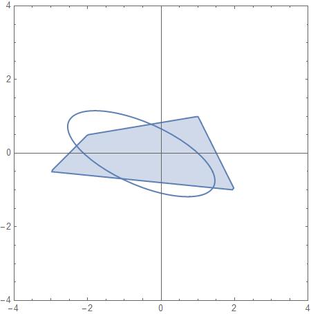

Was wondering if someone could help me understand two concepts involved with finding largest ellipse in a polygon? Some background:
First, I set up a set of half-plane representations for the example polygon below and as you can see my ellipse is not fitting too well in the polygon:

I don't understand the following:
(1) According to the Python reference Python link to John-ellipsoid, in order for the ellipse to be inside the polygon or ##\mathcal{E}\subset \mathcal{P}##, we must have ##\textbf{A}(\textbf{C}u+d)\leq b##.
(2) According to the Matheamtica reference (under Geometry applications) ConicOptimication in Mathematica, to maximize the area is equivalent to minimizing ##-\log(\text{Det}\textbf{C})## which is equivalent to minimizing ##-\text{Tr}(\textbf{C})##.
Would like to understand how (1) assures the ellipse is in the polygon and how (2) maximizes it's size and was hoping someone could help me.

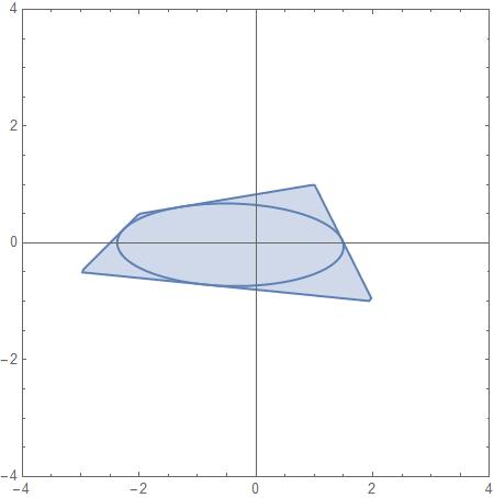

Here's the Mathematica code used to find the inscribed ellipse of the polygon using this method:
Mathematica:
rp = RegionPlot[{
   y - x <= 5/2  &&
     y - 1/6 x <= 5/6  &&
     y + 2 x <= 3 &&
    -y - 1/10 x <= 4/5}, {x, -3, 2}, {y, -2, 2}, PlotRange -> 4]
polyA = {{-1, 1},
   {-1/6, 1},
   {2, 1},
   {-1/10, -1}};
polyB = {5/2, 5/6, 3, 4/5};
constraints =
  Table[Norm[polyA[[i]].c] + polyA[[i]].d <= polyB[[i]], {i,
    Length[polyA]}];
{cEllipse, dEllipse} = {c, d} /.
  ConicOptimization[-Tr[c],
   constraints, {c \[Element] Matrices[{2, 2}], d}]
aFine[d_, m_, t_] := d + m[[All, 1]] Cos[t] + m[[All, 2]] Sin[t];
ePlot = ParametricPlot[aFine[dEllipse, cEllipse, t], {t, 0, 2 Pi}];
Show[{rp, ePlot}, Axes -> True, PlotRange -> 4]
