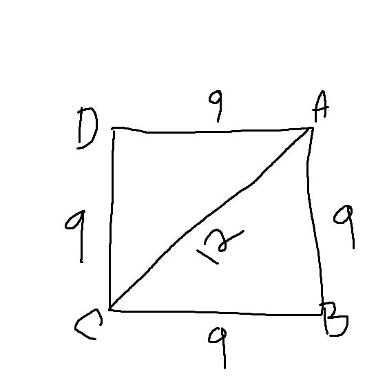

This is what I mean

Oh man, thanks a lot, then I suppose I have to do the following:
AB: (2-(-2)|10-2|4-3) AD: (5-(-2)|-2-2|7-3)
Then AC: (4+7|8-4|1+4)
Thus the C point is (11|4|5), right?
But this is somehow wrong because when doing calculating CD or BC I get don't get 9!
What am I doing wrong?
